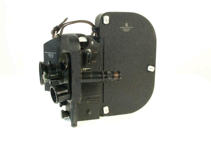

Gareth Blackstock Posted March 13, 2024 Posted March 13, 2024 So I came across this cine camera, quite a big thing, in a second hand shop. The shop owner initially told me the camera was off the floor, being stored in a private room. I seemed pretty keen, I thought it might be an old Auricon, he told me the camera was an old newsreel camera. He eventually took me upstairs to see the camera. From the distance I thought it was an Eclair, but getting closer it seemed to big. Anyway, turns out to be a pretty good condition Newman and Sinclair NS400. The attached picture is not of the actual camera, its from the net. The camera in the shop came with around 5 lenses and a magazine. Does anyone have any info on these cameras? Any documents? The shop owner seems keen to power it up, but I warned him off until he knows exactly what voltage etc is needed, otherwise he risks killing the motor. And the price tag is AUD$3600... Cheers, Gareth
Premium Member Simon Wyss Posted March 13, 2024 Premium Member Posted March 13, 2024 (edited) The 1962 NS P 400 has a pair of fixed pilot pins like the Bell & Howell 2709 or an early Mitchell, closer to the Mitchell AA movement which also pivots around a shaft above the gate. https://cinematography.com/index.php?/forums/topic/72258-mystery-camera/ https://archive.org/details/americancinemato43unse/page/38/mode/2up?view=theater&q=Newman Edited March 13, 2024 by Simon Wyss
Gareth Blackstock Posted March 13, 2024 Author Posted March 13, 2024 Hello, Simon Thanks for offering some valuable info on this camera. At least I can tell the owner it most likely runs on 12v. Cheers, Gareth
