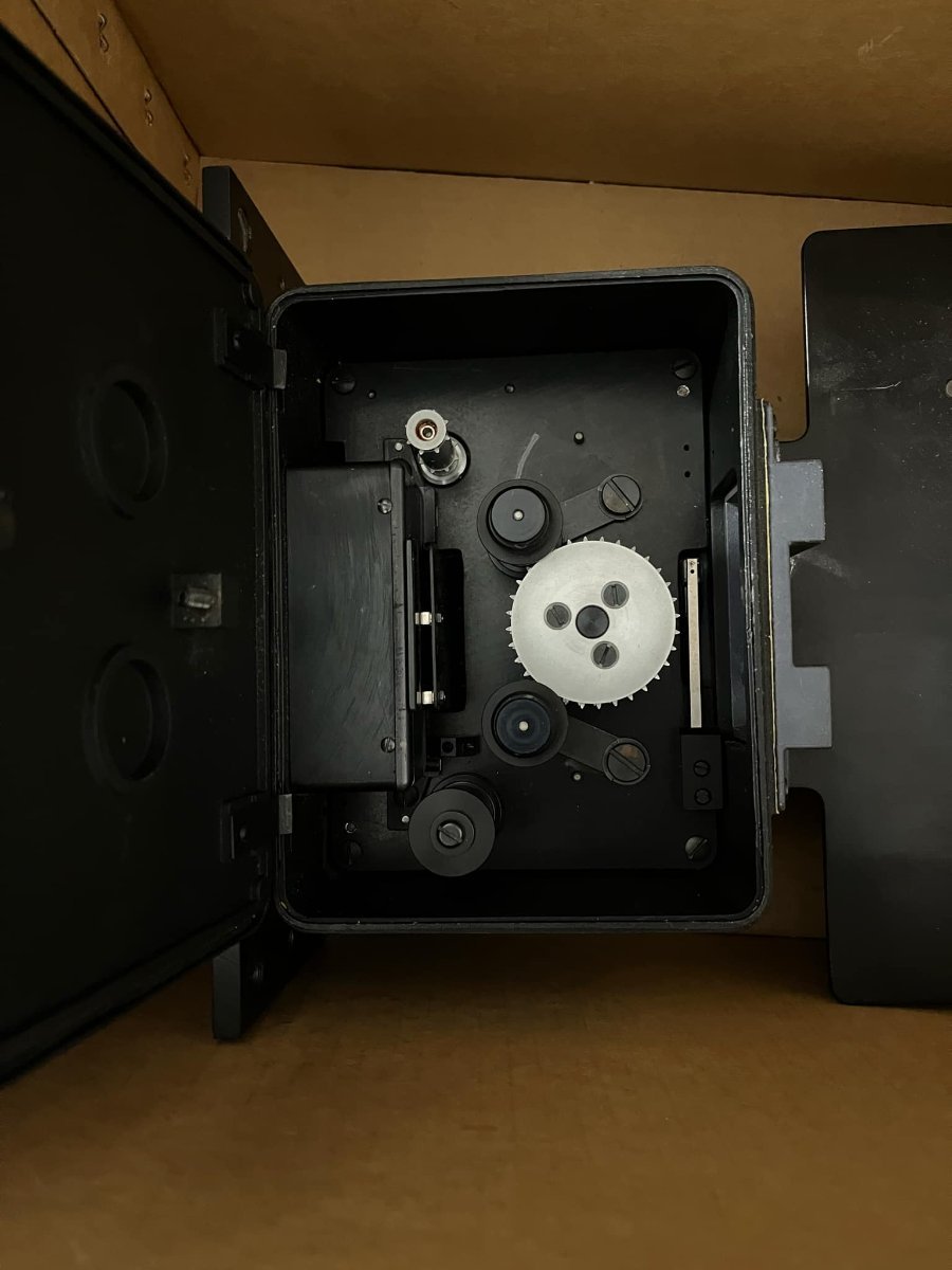

Geffen Avraham Posted April 7 Posted April 7 (edited) Two of these showed up at Community Thrift in San Francisco a few weeks ago, and I picked one up yesterday. American Cinematographer in 1986 says: Quote Oxberry has unveiled a 35mm computer camera with 750 frame capacity for unattended downloading of computer graphic images. The Oxberry PC-35 also offers pin-registration guaranteeing high-precision image placement for multi-image (multi-projector) slide effects. Daylight loading film magazines make it easy to process any length of film and to change film stock when desired. An optional 35mm Polaroid film magazine permits quick testing of computer and film recorder output. Automatic skip-marking assures accurate separation of 36 exposure strips for short roll processors. Film can also be marked manually to separate specific jobs. Roll-back multiple exposures are accomplished with forward and reverse jog controls and a digital frame counter. A separate display monitors the film remaining in the feed magazine. Both counters are resettable. The PC-35 Computer Camera is designed for easy retrofit to Matrix PCR film recorders. No factory alignment or modification is necessary. A simple technique and mounting procedure assure accurate field alignment. Seems like this was used in the 80s to print CGI to film! Looking inside, I saw a 2-phase stepper motor with what appears to be a glued-on optical encoder. The magazine feed and takeup are driven by Japan Servo 5000rpm DC motors with 10:1 gear reductions. There do not seem to be an actual computer inside - this is good! With a bit of help and experimentation, I can probably recreate the original controller, which I don't have, with a common MCU. Anyone ever worked with one of these, or have any docs for it? Here is the camera. Is it actually the PC-35 described in ASC mag? What kind of magazine does it take? A standard 400ft Mitchell? Edited April 7 by Geffen Avraham
Site Sponsor Robert Houllahan Posted April 8 Site Sponsor Posted April 8 These are for digital to film recording usually with a older CRT based recorder. 1

Site Sponsor Robert Houllahan Posted May 2 Site Sponsor Posted May 2 Easy to use to make a new film recorder (I have several at Cinelab for that purpose) it just takes removing the older motor (If equipped with one) and adapting a new stepper or servo motor to the shaft. Pretty easy to mod and make run, this one in the pic above has the smaller film magazine but some have Mitchell standard 400ft 1000ft and 2000ft magazines also. The 16K LCD with a RGB LED backlight seems pretty good very high res indeed. I am using a Micro OLED for the 16mm recorder which has vastly better contrast than any LCD and up to 2800nits brightness. Are those 16K LCDs available as a part? Will look at that too thanks.
