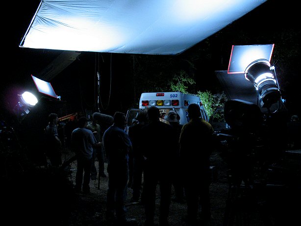

Premium Member David Mullen ASC Posted May 8, 2006 Author Premium Member Posted May 8, 2006 Since I lost my still camera on the shoot, I only have a couple of photos, not particularly interesting. I'm hoping the stills person can send me some of myself at work and some of the set-ups. Here are two. The first was for a close-up I had to shoot of someone standing in front of an ambulance, a pick-up from a day elsewhere that was shot at magic hour. So I recreated the soft blue-ish dusk light by bouncing two HMI's off of a 20'x20' (I think) frame of UltraBounce. I think the HMI's were a 4K and 6K. But because I only needed an f/2.8 at 320 ASA (500T stock) and the dusk light had to be a stop underexposed (i.e. my meter needed the soft light to read at f/2.0) I ended up cramming every scrim into the light and then using double nets also in front of the lights to knock it way down. I probably could have gotten away with using two 1200w HMI PAR's instead. The interior of the ambulance in the background had two 4' K32 Kino tubes taped to the ceiling. I also had a police light bar off-camera to recreate the original scene, which had police cars in it. The second was from the mud pit gag where the bed was surrounded by a rising tide of mud, lit with just a Kino Wall-O-Light. I had a frame of 1/2 CTO to create a half-blue look using K55 tubes, plus some 1/4 Minus Green gel because the Kino was reading a little green that day (I think the heat of New Orleans was causing the Kinos to get greener.) I had a 4'x4' black floppie as a top cut on the wall and the sides of the tank created a bottom cut, so I had a slash of soft light hitting the bed.
freddie bonfanti Posted May 8, 2006 Posted May 8, 2006 good stills! pictures like these help a lot us learners!!!!! its quite funny i was shooting an ambulance scene a week ago and i used the same setup with two 1200 hmis and ultrabounce!!!!! didnt have the kino tubes though. great job, cant wait to see the movie
Premium Member Luke Prendergast Posted May 8, 2006 Premium Member Posted May 8, 2006 There must be at least 10 scrims in front of that light!
