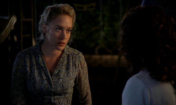

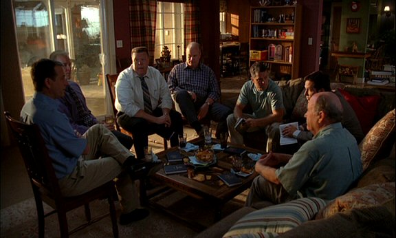

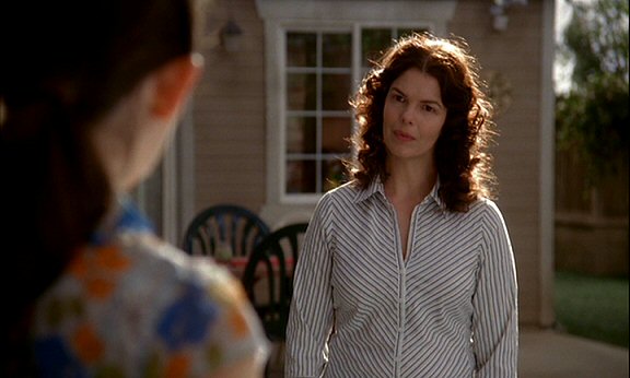

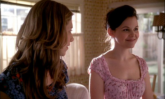

Premium Member David Mullen ASC Posted December 12, 2007 Premium Member Posted December 12, 2007 The DVD finally came out so I can show you some shots. Technical info: 4-perf Super-35, framed for 16x9. Shot mostly on Cooke 20-100mm zooms, some Panavision "Z" series primes (Zeiss). Kodak 5212 100T outdoors, but otherwise, mostly Kodak 5229 (Expression 500T). Later episodes used a mix of light diffusion on closer shots, either #1/2 Black Diffusion-FX, #1 GlimmerGlass, or a fine net. The Expression stock has a somewhat softer, powdery look, a little like Agfa. I'll begin with some frames from the backyard set, shot on a soundstage: At each end of the soundstage, I have Dinos to create a backlight. Overhead are spacelights. On this last frame, though, I wanted a toppier backlight so I extended a 20K on a small condor with an articulating arm to get over the porch trellace and create that shadow pattern on the side of the house. 1

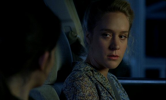

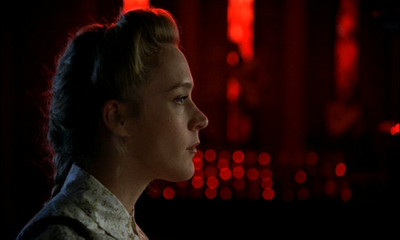

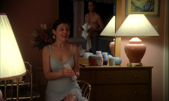

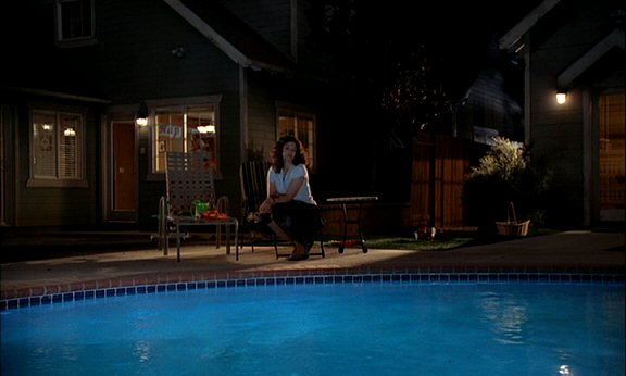

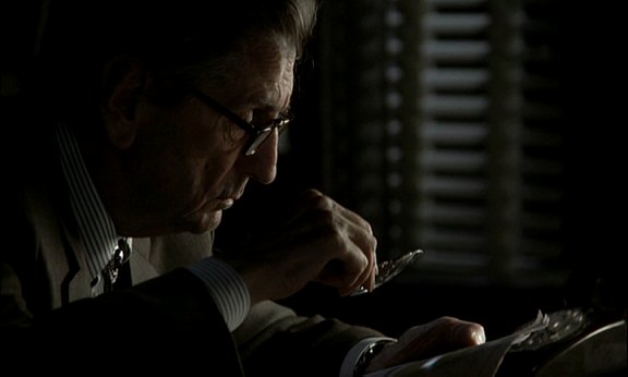

Premium Member David Mullen ASC Posted December 12, 2007 Author Premium Member Posted December 12, 2007 Some other random shots from the series. This first one cuts with a wide shot made at dusk outdoors (this was not on a soundstage) so I had to fake a dusk look when I got to the close-ups at night, throwing soft blue light on the background. I armed a Kinoflo with daylight tubes over the car door to get the soft light on the door sill.

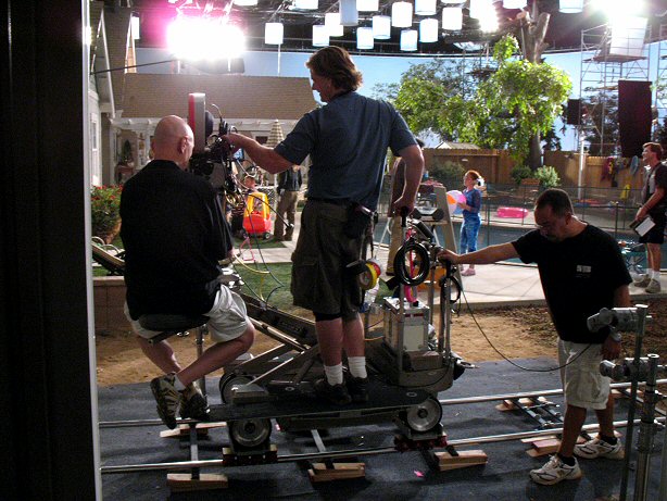

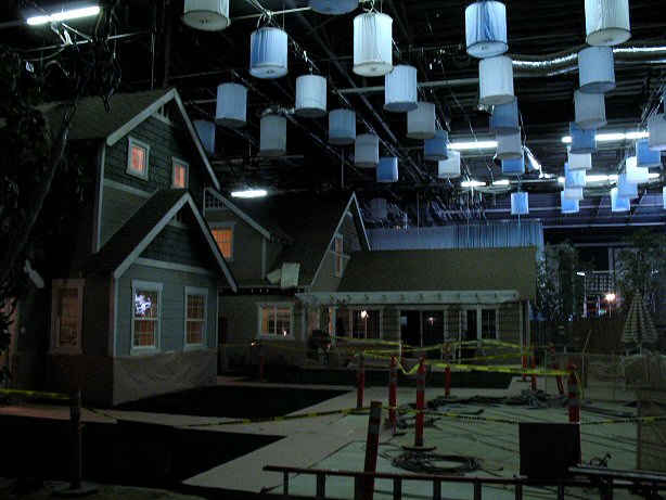

Premium Member David Mullen ASC Posted December 13, 2007 Author Premium Member Posted December 13, 2007 More backyard info... Here are some photos of the set, before production began while they were finishing up the touch-ups, and then during my first set-up in the backyard. The point is to show you that the Dinos were positioned behind the wings of the two houses at each end of the backyard, on scissor lifts. The problem was that the Dinos could not get high enough to tilt down into the yard of the nearest house, because of the roof shadow. So here, I added a 5K on a plywood sheet placed on the roof of the porch trellace so I could get the backlight to fall closer to the house and thus hit Barb in this position. I gelled it with 1/4 CTO to warm it up: Usually I opted to shoot in backlight, but here is a case where I armed a 20K overhead more to get the shadow pattern of the trellace, then threw a 4'x4' frame of diffusion on top of the trellace to soften/shadow the hard light that would be hitting Barb.

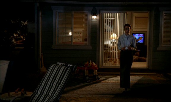

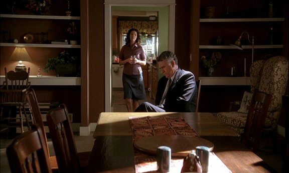

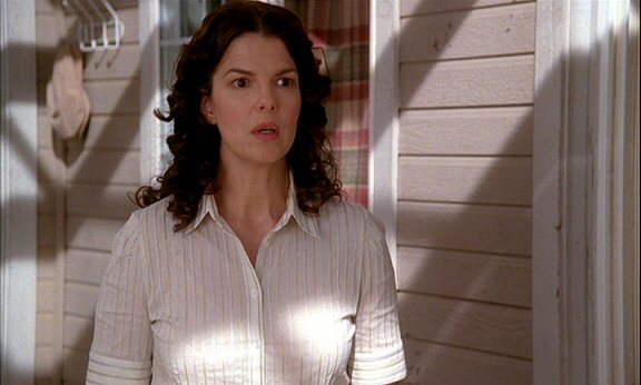

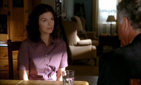

Premium Member David Mullen ASC Posted December 13, 2007 Author Premium Member Posted December 13, 2007 Another thing I started doing more of was using the Source-4's to get hot spots of light as if from the window, but slightly "misaiming" them so the people would only get hit partially. For example, in this frame, I cut the Source-4 backlight so that it hit Margene's head from the ears down rather than backlight her whole head, which looks a little more natural. The frame is also an example of the work in getting the backyard in the background to be reasonably overexposed. I felt that I had to get the backyard at least three stops brighter than the interior to be believable, which wasn't always possible because of the T/3 limit of the zooms.
Guest Stephen Murphy Posted December 13, 2007 Posted December 13, 2007 Thanks David, Great Photos of the exterior set. What stop were you shooting on the exterior set versus the interior?
Premium Member David Mullen ASC Posted December 13, 2007 Author Premium Member Posted December 13, 2007 I got an T/11-16 out of the Dinos and 20K's generally, and an T/5.6-8 out of the spacelights, when everything was on full. Since I had to shoot at T/3, I generally lit day interiors to a T/2.8, which got the background reasonably overexposed-looking, though the Expression stock actually held everything, even five stops overexposed or more, if you transferred it with the subject "down", which is what happened in dailies, since the colorist was not allowed to let anything get clipped. I spotted the 20K's and whatnot on any tree or fence in the background seen through the windows. Now when I was outside in the backyard, I lowered the intensity of the overhead spacelights down to a T/4 so that the hard light from the 20K's and Dinos would read relatively hotter in comparison -- to match real life outdoors conditions, I needed the sun and the shade to have at least a three-stop difference, more if possible. I could have dropped the overhead grid even lower, but since it was on a dimmer, it would start to get too warm in color temp compared to the Dinos and 20K's. Ideally I could have lit the backyard with the correct balance AND be three-stops brighter than the interior, so I could realistically Steadicam from indoors to outdoors and back again and do a stop-pull on the lens, like in real life. But since I had to lower the spacelights down to an T/4 to balance correctly with the "sun", when the backyard was lit correctly for being outside, it wasn't bright enough compared to the interiors, unless I switched to primes and lit and shot the interiors at T/2 or less to create enough of a difference. When the camera was only inside, then I could just turn on everything outside and blast more indiscriminantly, just to get the intensity up.

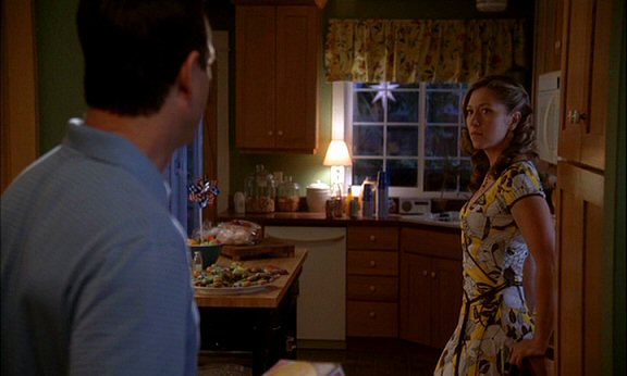

Premium Member David Mullen ASC Posted December 14, 2007 Author Premium Member Posted December 14, 2007 Another trick I used now and then, because gelling all the lights out in the backyard set was too time-consuming, was gelling the windows of the house for warm or cold effects, for all the angles in an interior scene. In this case, I put 1/2 CTO on the windows: Here I put Full CTB on the windows:

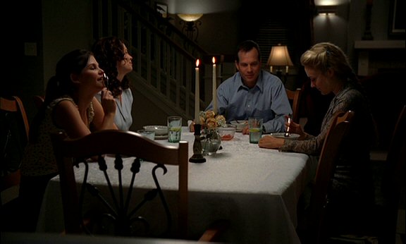

Premium Member David Mullen ASC Posted December 14, 2007 Author Premium Member Posted December 14, 2007 35mm is large enough that using 500T stock more often is not so much of a problem, grain-wise. And actually generally it will look less grainy in a dark night scene, not more. Grain is always most visible in midtones, and there are more midtones in a day scene generally. The only reason you may get more grain at night is if you underexposed overall more, so that the image had to be brightened in post. Lighting the backyard at night was easier in some ways. I left one or two of the half-blue gelled spacelights on for general ambience, and I sometimes added a moonlight edge from one of the towers, like by turning on only one globe from a Maxibrute, or putting a 5K or 2K on a rooftop, gelled half-blue. I usually used the swimming pool as a source of light in the scene too. I had two problems doing night exterior on the backyard set. One was that I wanted the interiors visible through the windows to look overexposed, which would happen in real life if you were outdoors in dim night lighting. But it was hard to get them to look bright enough. I wanted the effect of the bright houses spilling warm light into the night. The other problem was when there was a party or dinner scene set outdoors in creating a realistic light source. There wasn't enough practical sources out there to provide a key light, so often we dressed the scene with table lamps and what not. But the grid of spacelights was too high in the air to use them for lighting from for these scenes, so I had to put lights on rooftops and whatnot. Here are two night "exterior" shots:

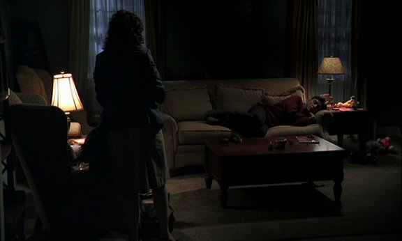

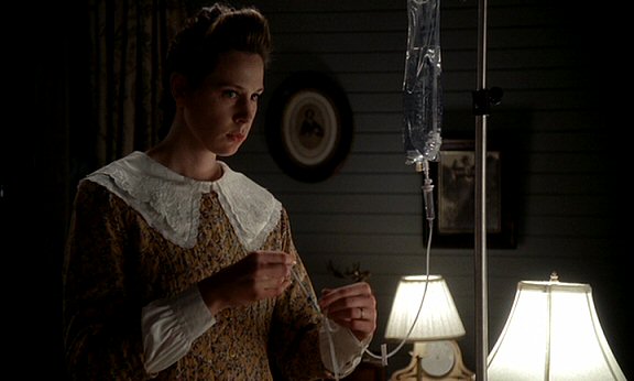

Premium Member David Mullen ASC Posted December 14, 2007 Author Premium Member Posted December 14, 2007 I generally put 213's in practical lamps because I wanted them to read hot on my T/3 zoom, to really put out some light. Then I augmented from off-camera, sometimes with a Source-4 bounced into a card. In this shot, I had a Chimera poking through a hole in the ceiling (a removable panel in the middle) to put a little light on the couch: There is some grain on the 5229, no doubt, but the question is whether a little texture is a bad thing for a realistic show like "Big Love". They actually had more noise problems in Season One because of the 5218 being underexposed too much in dark scenes. So I figured that 5229 overexposed a little (400 ASA), with its greater shadow detail, would minimize that problem.
