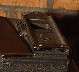

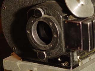

Premium Member Paul Bruening Posted January 18, 2008 Premium Member Posted January 18, 2008 Hello Gents, It's a mutant Mitchell. Please look over the pictures and let me know what you think it is. Here's what I can tell about it. It's serial is actually NC 390. It's mag mount is wider than the standard Mitchell mag. I don't know what lens mount it is. It locks down on the lens' flange. It is a pellicle reflex. It has "Mark Armistead" engraved on the aluminum lens opening cap. It has a plate on the side of the viewer that says, "CC Camera Equipment Incorporated, 315 W 43rd St. New York, NY. Model # NCX, Serial # 390". It was the motor that was serial # 54 NC 754. It's a whopping 115V synchro motor. What do you know about it? Thanks, Paul

Premium Member Stephen Williams Posted January 18, 2008 Premium Member Posted January 18, 2008 Hi, The NC's & possibly MK II's use the wider mags. Fries made an adapter so you can use the thinner mags. Stephen
Patrick Neary Posted January 18, 2008 Posted January 18, 2008 Hi- That looks like a Mitchell standard mount-

Leo Anthony Vale Posted January 19, 2008 Posted January 19, 2008 That's a helpful tip John, thanks. I might get some more info from that. Lol. No, Chuck. It's 4-perf 35mm. I checked that first. When I first pulled it out of the box, it occurred to me that his thing could be anything. Fortunately, it's only a little weird. Not completely weird. Even though it's a little roughed up on the outside, the works are pristine. I mean perfect. What a lovely bit of American machinery. I think Mark Armisted Rentals were on Formosa Avenue, off of Santa Monica. they were a relatively small place. F&B/CECO and CSC, both in NYC, modified Mitchells, Eyemos and 2709s to reflex and long before mictchell deigned to relex BNCs itself. & the wider magazines for the NC are probably thicker for more sound deadening. An NC movement with no film running throufh it has just the faintest whirr. All of the camera noise comes from the film flapping through and the motor. Florman & Babbs merged with Camera Equipment company to form F&B/CECO. The mount appears to be one of their turretless conversions. It is a Mitchell std.mt. with the quick mount thumb screws instead of 4 actual screws. One of the current TCM news features shows a similar camera pbeing used as the opening shot.
