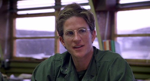

Premium Member David Mullen ASC Posted January 5, 2009 Premium Member Posted January 5, 2009 It's a bit confusing as a topic, but first of all, Kubrick did not primarily compose "The Shining" for 4x3 TV broadcast first and the matted widescreen theatrical release second. Second, whenever there is a possibility of two different aspect ratios, you generally compose for the more cropped ratio and protect for the less-cropped ratio because if you composed for the less-cropped ratio, then important information can be left out of the more cropped ratio. Third, whenever "The Shining" was shown at film festivals, Kubrick specifically ask that it be projected with a matte (usually 1.66) and not 1.37 Academy, which was a possibility in those venues. Fourth, the movie, as does "Full Metal Jacket", clearly frames with the widescreen matting in consideration, which I defacto say means that it was composed for that ratio. You can see the excess headroom in the 4x3 versions of these two movies that is typical of an unmatted widescreen "flat" movie: Unmatted: Cropped to widescreen: A movie specifically composed for 1.37 Academy looks a little different and often cannot be matted successfully to widescreen. Fifth, I've spoken to a couple of people who worked on those two movies and they all tell me that cameras and editing machines were all marked to show the widescreen cropping for theatrical and that the movie was composed for theatrical, though some differ on whether it was 1.66 or 1.85 they were composing for. So what's up with the whole 4x3 thing? It's not clear, but clearly Kubrick did not like electronic letterboxing for his 35mm flat movie shown on 4x3 television -- however, since he died just as 16x9 TV and monitors were becoming more popular, we have no idea what his views would be should all of his movies end up being shown mostly on 16x9 monitors. In the case of "Clockwork Orange" and "Dr. Strangelove", he preferred that the movies be transferred unmatted but that any camera mattes become visible, hence why the aspect ratio varies in both movies. In the case of "Barry Lyndon", you'll see a consistent widescreen camera hard matte throughout. In the case of "The Shining", "Full Metal Jacket", and "Eyes Wide Shut", you have an unmatted camera negative that Kubrick did not want electronically matted for 4x3 TV. Why? Well, one reason was that he did not object to the way that it looked because he liked old 1.37 Academy movies and 4x3 TV was one way of seeing those movies in a format that resembled Academy. However, that does not mean that the movies were composed to be viewed that way only. But you could argue that they were composed to make it possible to show them both in widescreen in theaters and 4x3 full-frame on TV. Also, knowing back then that most TV stations would show it 4x3 full-frame anyway, he perhaps preferred to have it work for that ratio rather than look zoomed into. But I would argue that the movies were composed for cropping to widescreen and protected for full-frame viewing, which is not anything new in moviemaking, it's just that Kubrick preferred that the earlier transfers for home video, including the laserdisc market, show the full camera negative image. There was a big release of his movies on DVD as a boxed set just around the time of his death. He was working on the editing of "Eyes Wide Shut" at the time and I suspect, rather than spend all the time (which he didn't have) as he did supervising the earlier transfer for the laserdisc versions, he told Warners to just use those earlier transfers instead, which they did. "Eyes Wide Shut" is an interesting case though because he was not around to see that transferred for home video. Unlike "The Shining" and "Full Metal Jacket", the 4x3 version does not seem to suffer from excessive headroom in close-ups and medium shots and looks more "composed" for 4x3. I suspect that, because he wasn't around to object or to supervise, the people in charge did the more typical thing of reframing the 4x3 version to look more correct, headroom-wise, than simply transferring it unmatted, which is probably how Kubrick would have insisted they do it. I think Kubrick probably viewed the fact of a 4x3 TV version as an opportunity and not a burden, hence him shooting his later movies with this version in mind. But I think they were always intended first as theatrical experiences and second as television ones.
