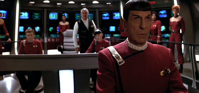

Premium Member David Mullen ASC Posted May 6, 2009 Premium Member Posted May 6, 2009 You gain vertical resolution with anamorphic because you aren't cropping top & bottom to get 2.40, but you're losing horizontal resolution because you're cropping the sides to get 2.40 (unless you shoot with the 1.3X anamorphics by Hawk). So it's a wash -- if you choose to shoot in anamorphic on the RED, it's really only because you want the look of front-anamorphic primes and all of their optical artifacts when shoot near wide-open (flares, stretchy backgrounds, etc.) If all you want is a crisp, sharp 2.40 image, then shoot with good spherical lenses and crop. Shoot in the T/1.3 to T/2 range if you want a shallow focus look similar to anamorphic at T/2.8-ish. I posted these example on RedUser that you may find useful. Anamorphic (Star Trek 5) Super-35 (Star Trek 6)

Premium Member David Mullen ASC Posted May 7, 2009 Premium Member Posted May 7, 2009 Any idea what stop each of those examples was shot at David? No, but it looks like in the T/2.8 range. Photography on the bridge set has generally been around T/2.8 just to get all the lights to read well. In the original, "Star Trek: The Motion Picture" they also had to expose for a lot of 16mm projection simulating those monitors, which were replaced by CRT's for "Star Trek 2". So there was a lot of use of split-diopters in the first movie to compensate for the lack of depth of field, deep-focus framing being one of Robert Wise's favorite techniques. "Star Trek 3" was sort of the exception -- the DP wanted more sharpness out of the anamorphic lenses and shot much of the movie at T/5.6, even push-processing the 5294 negative for the bridge scenes to make that possible. Of course, any zoom shots in these anamorphic Trek movies would have to boost the light level to near T/5.6 -- you can see the difference in "Star Trek: The Motion Picture", the lights on the consoles don't expose as brightly because the light level was boosted for zoom lens shots (not many of those however). You also see that in the VistaVision bluescreen shots whenever the main screen was in the shot. The early Star Trek movies all demonstrate the progression of film stocks well because as soon as a new high speed stock was available, the Trek movie was trying it out just to handle the bridge set. Trek 1 was shot on 5247 (125 ASA) as there was no high speed stock, then Trek 2 was shot on Fuji 250T, the first high speed stock, then Trek 3 was shot on 5294 400T, then Trek 4 as well, plus some of the new bluescreen stock 5295 400T. Trek 5 I think opted to stick to 5294 rather than 5295.
