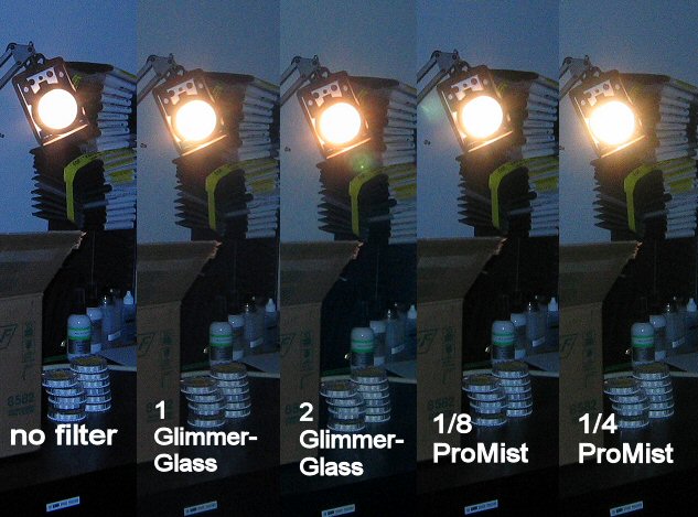

Premium Member David Mullen ASC Posted February 3, 2005 Author Premium Member Posted February 3, 2005 I took these digital stills today over at Panavision to demonstrate the amount of halation from the filter, although I didn't quite hold the #2 GlimmerGlass correctly against my lens and got an extra flare. But you can see that the #1 & #2 GlimmerGlass are less strong than a #1/4 ProMist.

Premium Member Wendell_Greene Posted February 7, 2005 Premium Member Posted February 7, 2005 I took these digital stills today over at Panavision to demonstrate the amount of halation from the filter, although I didn't quite hold the #2 GlimmerGlass correctly against my lens and got an extra flare. But you can see that the #1 & #2 GlimmerGlass are less strong than a #1/4 ProMist. <{POST_SNAPBACK}> Thanks David for posting the stills.
