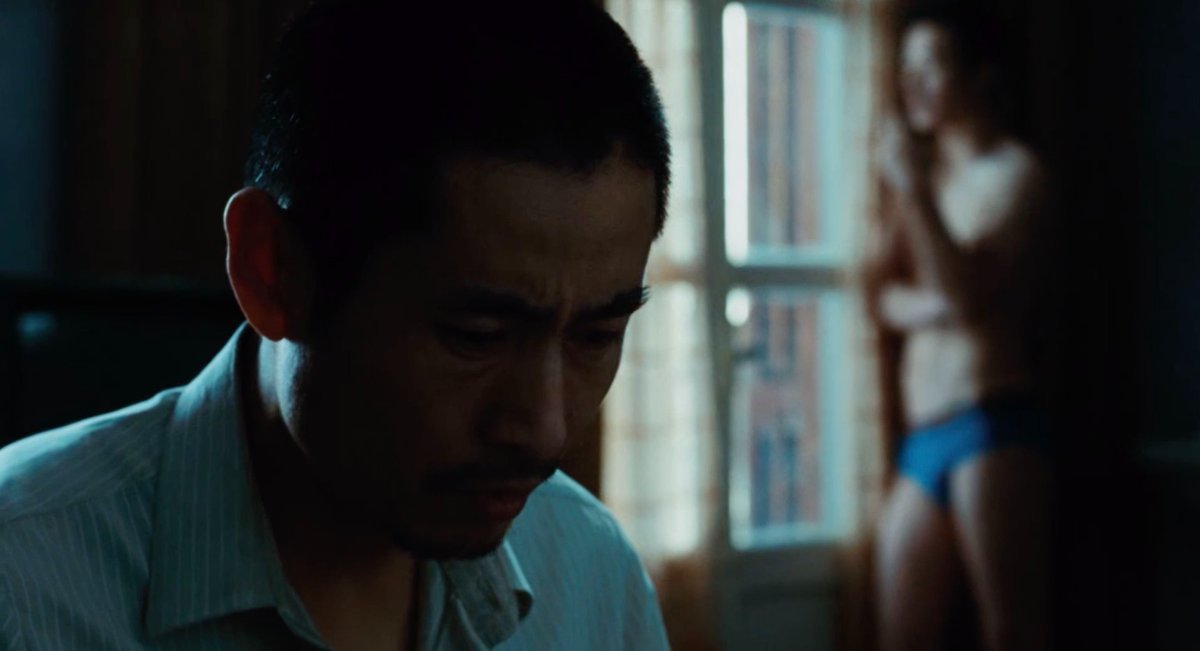

Yasutake Torii Posted June 22, 2011 Posted June 22, 2011 Hi guys, I wonder how the film Biutiful is color graded. Or is it mainly the effect of their choice of film they shot on? But anwyays, I wonder if the look on Biutiful is achievable in post. reference(pics): http://cinema.theiapolis.com/movie-2SMV/biutiful/gallery/javier-bardem-as-uxbal-in-biutiful-2010-1045016.html http://images.allmoviephoto.com/2010_Biutiful/2010_biutiful_001.jpg (movie trailer) http://www.movie-list.com/trailers.php?id=biutiful Thank you! yaztj

Premium Member Phil Rhodes Posted June 23, 2011 Premium Member Posted June 23, 2011 Thanks for the analysis - interesting. One query. In the first of Yasutake's examples, there's a shot of a man sitting against a wall which appears to be pale blue. Is that actually a blue wall, or was it lit or graded to look that way? Probably a silly question, but I like the separation of color in the shot. P
Rodrigo Prieto Posted June 24, 2011 Posted June 24, 2011 Hi Phil, That was the color of the wall. It is a small doctor's office, and it was lit with an 18 K through the window out of shot with Full Grid Cloth diffusion just outside the window, and a flag inside to darken one third of the wall behind Bardem. He was also lit with an overhead 4x4 Kinoflo with Cool White bulbs gelled with 1/4 Minus Green. On the dark side of his face, I placed a black 4x4 card for negative fill. Cheers! Rodrigo.
Premium Member David Mullen ASC Posted June 24, 2011 Premium Member Posted June 24, 2011 Thanks so much for participating in this forum Rodrigo! By the way, why Cool Whites with 1/4 Minus Green as opposed to Kino 55's or Chroma 50's, something with less green in it to begin with?

Premium Member Phil Rhodes Posted June 24, 2011 Premium Member Posted June 24, 2011 less green in it to begin with I was about to ask the same thing. P
Rodrigo Prieto Posted June 25, 2011 Posted June 25, 2011 Thanks so much for participating in this forum Rodrigo! By the way, why Cool Whites with 1/4 Minus Green as opposed to Kino 55's or Chroma 50's, something with less green in it to begin with? Hi David! In my lighting package I had quite a few cool white bulbs as there are many scenes with fluorescent lighting in which I used cool whites exclusively to match existing lighting or to keep the green/cyan look of cool whites. On the doctor's office I wanted Uxbal (Bardem) to have a combination of white daylight on one side of his face, combined with cyan fluorescent top-light to add discomfort to the moment. I felt that Cool Whites slightly corrected gave me the right amount of greenish top-light for that moment. For other scenes I used Chrome 50's clean and in some cases even added a bit of plus green and 1/4 blue to the bulbs. For example the scene in the sweatshop where the Chinese immigrants work was lit with cool white bulbs, but the office of the boss seen in the background was lit with Chroma 50's gelled with 1/4 Plus Green and 1/8 CTB. I then graded to make the office or the boss "neutral" in color so that the rest of the sweatshop would still be cyan/green but not as extreme as if I had left the office Chrome 50's without gels and graded to that. Rodrigo.
