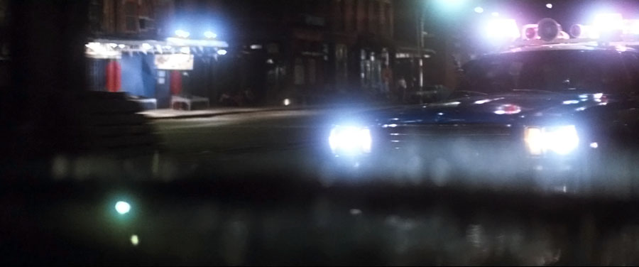

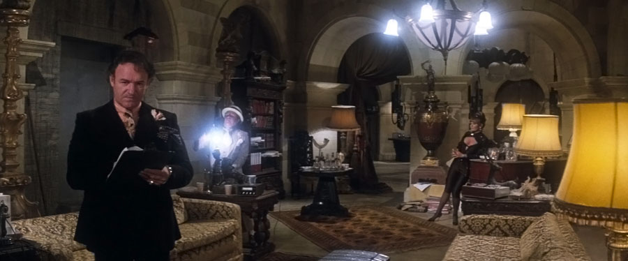

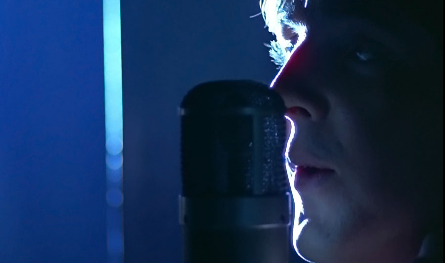

Premium Member David Mullen ASC Posted April 10, 2017 Premium Member Posted April 10, 2017 There are three reasons for a blue-ish edge or glow around lights back then in the 1970's. One is that many old lenses back then had some chromatic aberration (CA) problems and a blue fringe around hot areas like lights was one artifact. Second, many of the low-contrast and fog filters popular back then had a blue-ish bias to the glow that they created. Third, streets were lit with mercury vapor streetlamps back then, which rendered as blue-green on tungsten film at night. Also Cool White fluorescents render blue-green on tungsten-balanced stocks. 1
Premium Member David Mullen ASC Posted April 10, 2017 Premium Member Posted April 10, 2017 Example of blue CA fringing around a bright edge in "Help!" (probably Cooke Speed Panchros): Example from "Superman" of blue glow from Harrison Fog Filters, plus blue from Cool While fluorescents and mercury vapor streetlamps (but headlamps are tungsten): Even ordinary light bulbs have a blue glow because of the fog filters: I should add that "Superman" was shot on Panavision anamorphic lenses, which also create a blue horizontal flare around bright lights. But most of the blue glow you see here is from the Harrison Fog Filters. 1
Brook K Posted April 10, 2017 Author Posted April 10, 2017 Example of blue CA fringing around a bright edge in "Help!" (probably Cooke Speed Panchros): Example from "Superman" of blue glow from Harrison Fog Filters, plus blue from Cool While fluorescents and mercury vapor streetlamps (but headlamps are tungsten): Even ordinary light bulbs have a blue glow because of the fog filters: I should add that "Superman" was shot on Panavision anamorphic lenses, which also create a blue horizontal flare around bright lights. But most of the blue glow you see here is from the Harrison Fog Filters. EXACTLY the look I was referring to! Looks like fog filters are the way to go to achieve that effect then. I always thought it was ONLY from using tungsten film but now I know there is more to it. :) Thanks David!
Premium Member David Mullen ASC Posted April 10, 2017 Premium Member Posted April 10, 2017 Low Cons from that era also have a blue cast around halation, just less than fogs. The newer (early 2000's) Tiffen Smoque filter also has a bit of blue in its halation. 1
