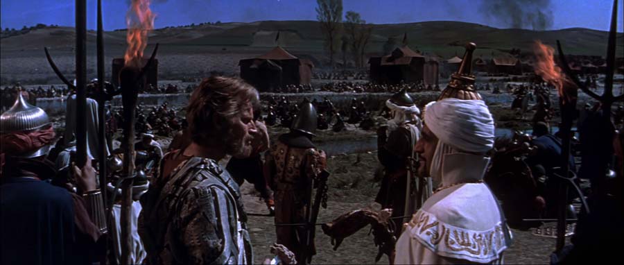

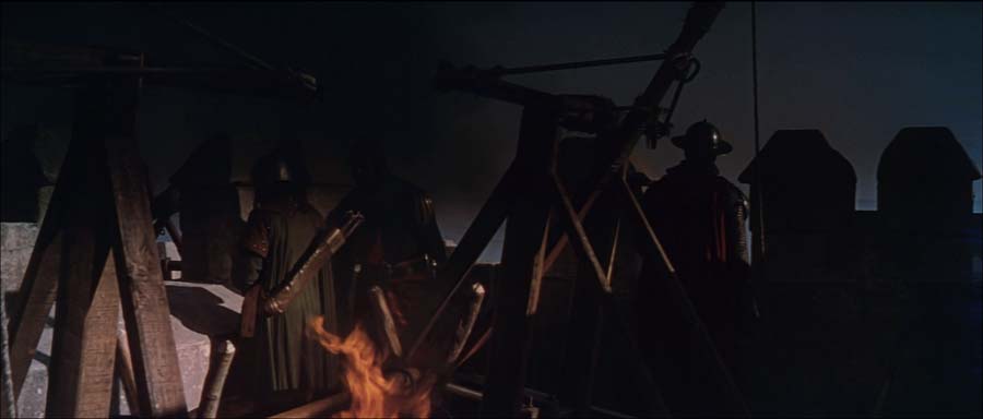

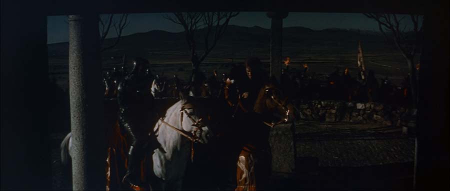

Premium Member David Mullen ASC Posted October 31, 2017 Premium Member Posted October 31, 2017 Here are some examples of day-for-night with fire, from "El Cid". You can see the problem, that the fire isn't realistically bright. It works best in that close-up of Charlton Heston where at least it was late enough into the afternoon that the sun wasn't so bright. They used Polas and ND grads when they could. It was considered problematic even back then, enough so that William Clothier, who shot mostly day-for-night on John Ford's movies, convinced John Wayne to shoot night scenes with campfires at night for "The Alamo" (he said that Ford hated working at night so preferred day-for-night.) At least with overcast-for-night (which was done well in "Wyatt Earp"), you can mix that with dusk-for-night since both don't have hard shadows from the sun.
Hannah Getz Posted November 1, 2017 Author Posted November 1, 2017 Thank you so much for these! I did a test the other day in an overcast environment and it turned out alright, colors and skintones were retained, however I'm not sure the grade was entirely convincing as night. Need to give it a whirl in full sun!
