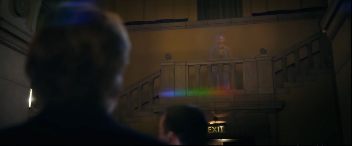

Alissa Alexina Posted February 13, 2021 Posted February 13, 2021 Can anyone tell more details about the rainbow spectrum filter in Bliss (DP Markus Förderer)? Online articles mention a "custom light filter", but this is too vague of course. There is a BTS photo available, but I am not sure what is going on there, are they using some kind of prism as well? I think the effect is unique and beautiful - lnever overwhelming or cheesy like in commercially available filters - and wonder if it is possible to DIY something like this. 1

Premium Member Phil Rhodes Posted February 14, 2021 Premium Member Posted February 14, 2021 That's a diffraction grating of some kind. No idea where you'd get one that big or how you control the density. P
Alissa Alexina Posted February 14, 2021 Author Posted February 14, 2021 Thank you! So it is indeed a rectangular filter in the mattebox. I was wondering how they achieved the spectrum effect in various frame regions, without direct light sources - from the BTS it looks like they were strategically hitting the filter with a flashlight! The diffraction grating film may be available somewhere like aliexpress... worth experimenting ?
Premium Member Phil Rhodes Posted February 14, 2021 Premium Member Posted February 14, 2021 I'm not sure how exactly he has it mounted; it could be clamped onto the edge of the mattebox with a magic arm to catch a light that's coming in at some odd angle.

Premium Member Phil Rhodes Posted February 15, 2021 Premium Member Posted February 15, 2021 13 minutes ago, David Mullen ASC said: I don't know if you can shoot through this stuff... I would expect it to turn the whole frame into a smeared spectral mess, splitting up the whole picture. The shots Alissa cites look like glints reflecting in from outside the main picture area, almost like the effect you get when mounting a prism on the mattbox on a magic arm, or something like that. I wonder if that's how it was done. P
Premium Member David Mullen ASC Posted February 15, 2021 Premium Member Posted February 15, 2021 Or perhaps the diffraction sheets were cut into thin strips and placed across the frame selectively. Or some sort of thin prism like you say. Or perhaps some glass was at a 45 degree angle to the lens reflecting a diffraction sheet that then had a small light hitting part of it, so the camera only saw a reflection of that one area of the sheet?
Alissa Alexina Posted February 16, 2021 Author Posted February 16, 2021 Thank you David! I was thinking of cutting the film into strips for selective placement on a clear filter, too. Although Markus Förderer"s filter is totally covered with holographic film, probably they were able to find something translucent enough. Phil, no, we did not use a prism in the test shots. Somehow the Cokin diffractor multiplied the lightsaber light, though it was not supposed to ?
Stuart Brereton Posted February 16, 2021 Posted February 16, 2021 23 hours ago, Phil Rhodes said: I would expect it to turn the whole frame into a smeared spectral mess, splitting up the whole picture. Yet the filter he's holding in the picture on his website appears to have diffracted light across the whole surface.
Premium Member Phil Rhodes Posted February 16, 2021 Premium Member Posted February 16, 2021 6 minutes ago, Stuart Brereton said: Yet the filter he's holding in the picture on his website appears to have diffracted light across the whole surface. It seems I might be in a position to answer this definitively fairly soon; wait out!

Premium Member Phil Rhodes Posted February 22, 2021 Premium Member Posted February 22, 2021 Short answer: it's a special. The filters used for Bliss were specially built some time ago. Two exist, owned by Markus, and have not been used on anything else. This is not the IB/E thing, but they look similar.
