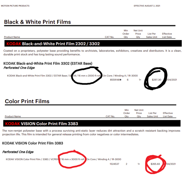

Joshua Robert Dy Posted December 4, 2021 Posted December 4, 2021 Hey film student Zoomer here. I'm already thinking about the required student film thesis I'll make in 2025 (leaning towards 16mm Tri-X) and while checking prices for print films, I noticed smth weird (see image attached): 3 1000 ft reels of 16mm Color Print Film is cheaper than 2 1000 ft reels of B&W. Why? Is it because Color Print Film could only print from negatives/intermediates while B&W can do those + reversals? Is it because no one makes B&W films anymore? so for more context, I'm planning on making a 2-reeler feature length film < 55 minutes runtime; originally in B&W because I had thought that making B&W films is cheaper; if previous statement proves to be wrong, this changes things for me, a broke film student. Why am I looking to release print films for a student film? hehe cause I want to distribute it imma win Palme d'Or & Best Picture
Premium Member Charles MacDonald Posted December 5, 2021 Premium Member Posted December 5, 2021 B&W was always a niche product, and so might be more because of that, also it MIGHT require more silver as the image in B&W is silver, while the colour stock may use less. You may also want to note that it looks like they will sell ONE CAN of the Vison Color, But you need 3 cans worth to get the 3302. {16mm print film is almost always only sold as two rolls in a 35mm can.} you might want to inquire with the Filmotek- ORWO folks. to see what they offer as an equivalent.
Joshua Robert Dy Posted December 5, 2021 Author Posted December 5, 2021 Thank you for the explanation Charles! I am quite insistent on using the 16mm Tri-X reversal film because our uni has a 16mm projector that I want to use so bad, however I guess I should now seriously consider using Double-X negative film [im also very stubborn on making it B&W] instead so that I could print it on the cheaper Vision Color. 34 minutes ago, Charles MacDonald said: you might want to inquire with the Filmotek- ORWO folks. to see what they offer as an equivalent. I had not seen the alternatives to Kodak, so thanks imma take a look at them! Once again, thank you Charles for the reply; this is some really rad info ?
