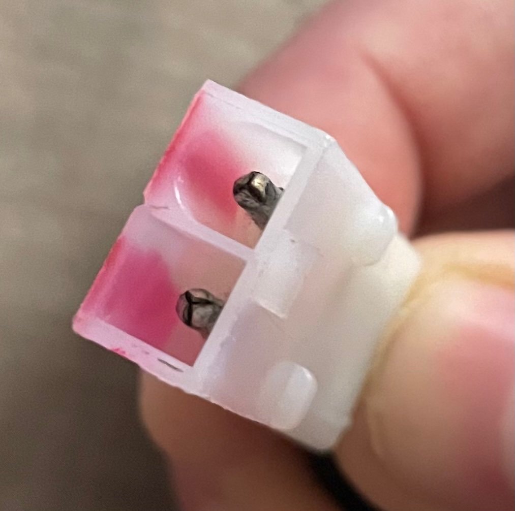

Raymond Zrike Posted February 18, 2022 Posted February 18, 2022 Does anyone know the name of this connector? My Eclair ACL came with a cord that is on one end a 4-pin Jaeger and on the other end this connector (and then I also have a male version of this connector that also goes to a 4-pin Jaeger). I’m trying to figure out alternative ways to power my ACL for the inevitability of my batteries dying. The ACL’s Jaeger connector is really rare and really annoying.
Premium Member Tristan Noelle Posted February 18, 2022 Premium Member Posted February 18, 2022 Kind of looks like a Tamiya or Mini Tamiya, which are often used in RC car batteries or Paintball/Airsoft applications. Not sure though. -Tristan 1
Raymond Zrike Posted February 18, 2022 Author Posted February 18, 2022 (edited) 2-pin Molex, maybe? Edited February 18, 2022 by Raymond Zrike
Raymond Zrike Posted February 18, 2022 Author Posted February 18, 2022 7 minutes ago, Tristan Noelle said: Kind of looks like a Tamiya or Mini Tamiya, which are often used in RC car batteries or Paintball/Airsoft applications. Not sure though. -Tristan Wow it does look a lot like that too. Hmm... I think you might be right. The wikipedia page for Tamiya connector says they're used for battery packs.

Steve Switaj Posted February 25, 2022 Posted February 25, 2022 The circuit board is a voltage regulator. The chip is an LM2596, a common step down switching regulator, the black potted cylinder is an inductor. The blue trimmer pot in all likelihood sets the output voltage, that type of pot usually has multiple turns, so they are used for fine adjustment.
Steve Switaj Posted February 25, 2022 Posted February 25, 2022 The connector looks like something out of one of the Molex pin & socket families, but there are a bewildering array of options to those. Can you measure the pin pitch? Common pitches are 6.3, 6.7, 7 or 9.9mm
