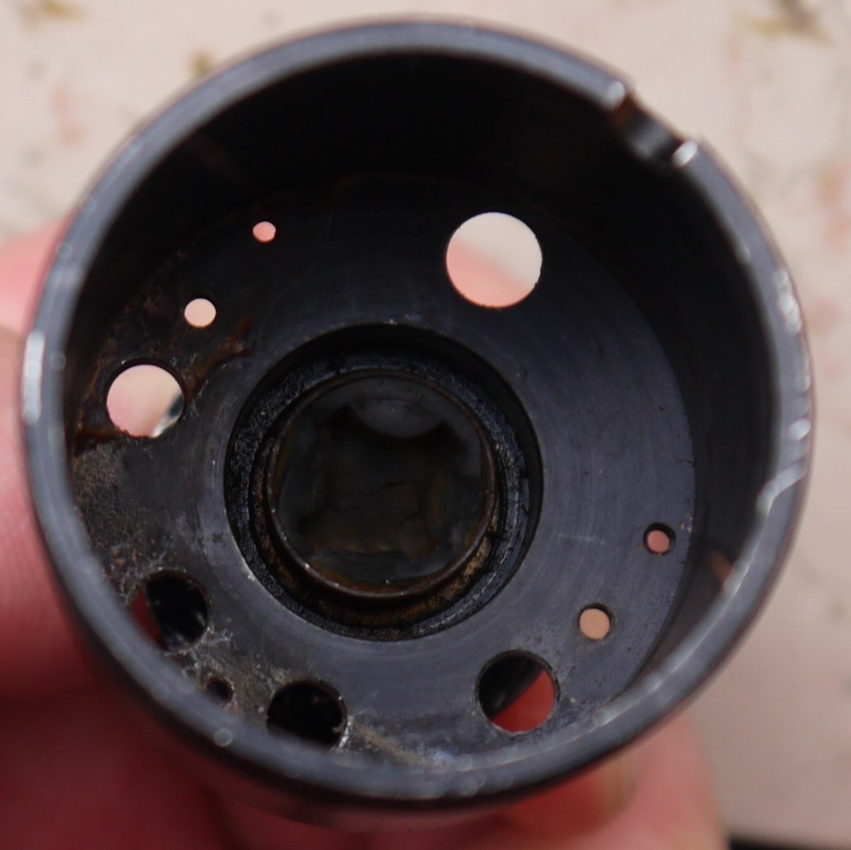

Amidst my first case of Beaulieu News 16 I’d like to share my fresh insight.
A client has sent me two examples, one for spare parts. The mechanism of both doesn’t budge. The motor spins.
After four hours of ruthless disassembly of the parts example, I cut all the electric lines that ought to be soldered off correctly, I have come to the conclusion that this is the worst 16-mm. camera by far. The fastest moving parts, that is the motor coupling, the friction clutch behind it and the speed sensor, form the innermost group. One has to dismantle everything in order to separate that group. A fresh rubber coupling? Friction parts? I don’t know where to procure. The problem with the present examples is that no spare parts are useable, they’re all totally rotten. The speed sensor grinds.
It is impossible to lubricate anything of the gear train or a bearing from the outside. These were just made to make money. Today, more than half a century later, the remaining Beaulieu News are dying.
Mechanics always come first, then optics, then everything else. If somebody wants to endeavour a thorough service, s/he better prepares to at least a grand in cost, at least with me. On the photo I’m showing the motor receptacle. To the left of the gear is the clutch, on the right would sit the sensor.
What a primitive friction clutch. It consists of a spring and a flat washer between the steel bush, second from left, and the C clip.
I don’t have a specification on the torque it should hold but from feeling it’s too weak.
The steel bush within the black anodized group body is pressed in. In its bore sits the smaller ball bearing. The bigger ball bearing is held on about a quarter to a third of its length by the black plastic ring, second from right. A strange affair, I must say. According to Marcel Beaulieu the project dates back to 1966 or 1967.

Two aspects of crucial mechanical elements stand out.
  1. Size. To give a friction clutch or any other coupling the dimensions it needs is important. Larger areas or surfaces allow better control of forces. I think this is obvious with the Beaulieu News toy thingy.
  2. Accessibility. I did find a way to remove the motor group without having to desolder one electric line but the rest of the mechanism is still hidden packed. I dream of a camera that opens like the door of a fridge.
Is it my imagination, or is everything in your first disassembly picture fairly coated with corrosion?  Bad sealing design?  Bad storage?  For some reason, people like to stash old no longer needed cameras away in very wet environments, so when they come out decades later and go to an estate sale and then ebay, with everyone just assuming it might work, you end up discovering everything coated with green and brown fuzz.  It's why I'm such a lowballer on untested cameras on ebay., especially when they only have a couple of crummy pictures.
The other camera is in good shape but I returned both declining further work. The client accepted my decision. He wrote he thinks I was very close to solving the problem.
He didn’t quite understand. So be it published for everybody dealing with the Beaulieu News 16:
  • There are no spare parts tangible. Those from the parts example  were more or less unusable. The rubber coupling has an intricate form. In addition I’d have had to find a suitable torque strength of the friction clutch.
