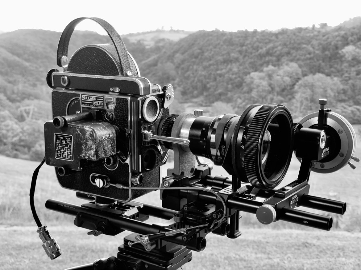

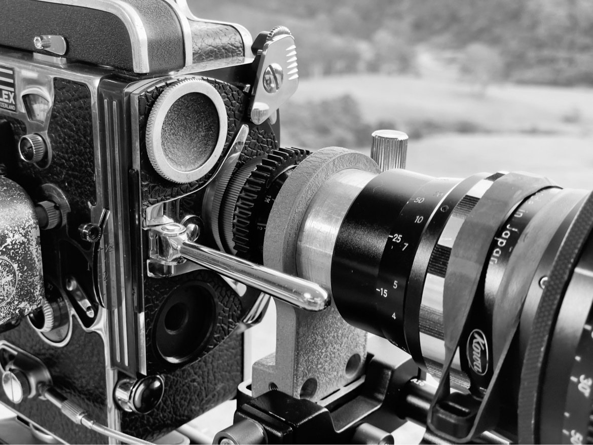

Bill Hunt Posted January 2, 2025 Posted January 2, 2025 A couple of adapters and a diopter away from testing. It’s not pretty but it should work. Not a flat base model, but the rails are as sturdy as I could wish for. You can literally swing the camera off them—I only did it once… 1
Premium Member Dom Jaeger Posted January 3, 2025 Premium Member Posted January 3, 2025 Look forward to hearing how it goes!

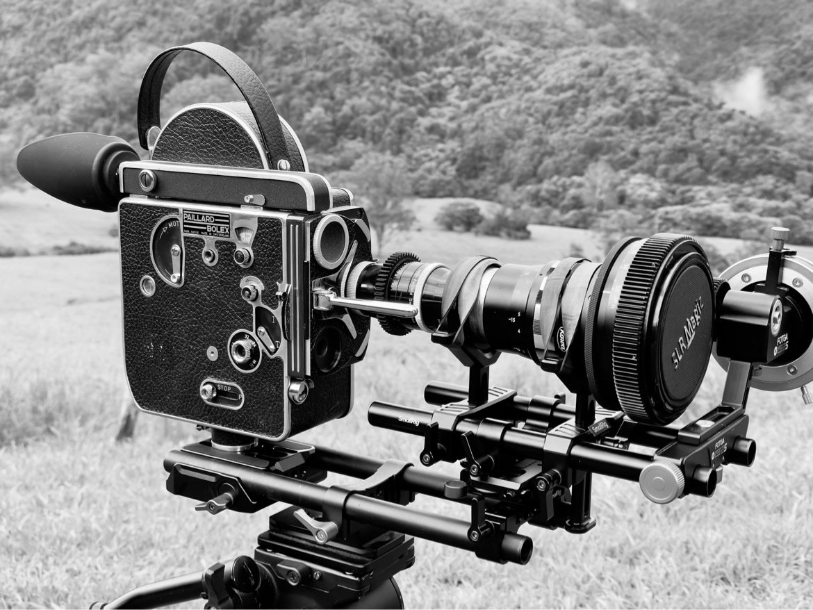

Bill Hunt Posted January 13, 2025 Author Posted January 13, 2025 There’s a few minor modifications I’d still like to make, but this build works really quite effectively in purely mechanical terms. Although the lens(s) are quite adequately supported I’d still like to acquire a plug. Running a roll of film will tell the definitive story. Happy to respond to any questions. 1 1

Premium Member Dom Jaeger Posted January 14, 2025 Premium Member Posted January 14, 2025 Hi Bill, I would absolutely recommend getting a turret plug and maybe even a top lock assembly for the turret if you are going to fit a long, heavy lens like this. Otherwise, you need to make absolutely sure that the support is set exactly to the right height and centre, because it doesn’t take much to pull the turret away from the camera front and throw your focus out, or worst case begin to permanently deform the turret plate.
Bill Hunt Posted January 14, 2025 Author Posted January 14, 2025 7 hours ago, Dom Jaeger said: Hi Bill, I would absolutely recommend getting a turret plug and maybe even a top lock assembly for the turret if you are going to fit a long, heavy lens like this. Otherwise, you need to make absolutely sure that the support is set exactly to the right height and centre, because it doesn’t take much to pull the turret away from the camera front and throw your focus out, or worst case begin to permanently deform the turret plate. Thanks Dom, I’ve put a lot of effort into getting the alignment right, but yes, I’m with you on making absolutely sure. I’m still on the lookout for both items.

Bill Hunt Posted January 15, 2025 Author Posted January 15, 2025 There’s a complete upper locking assembly on the way from Du-All which should assuage Dom’s and my own concerns about the turret. I’ve also added another support which is now located under the first adapter (taking lens to Kowa). The second support means the whole lens assembly is independent of the c-mount, but for the fact that it remains attached to the turret. What I would like to do at some point is make/modify an adapter that’s made of two pieces which slide into each other rather than being threaded. This would mean I could simply slide the whole assembly forward to allow for lens swaps.

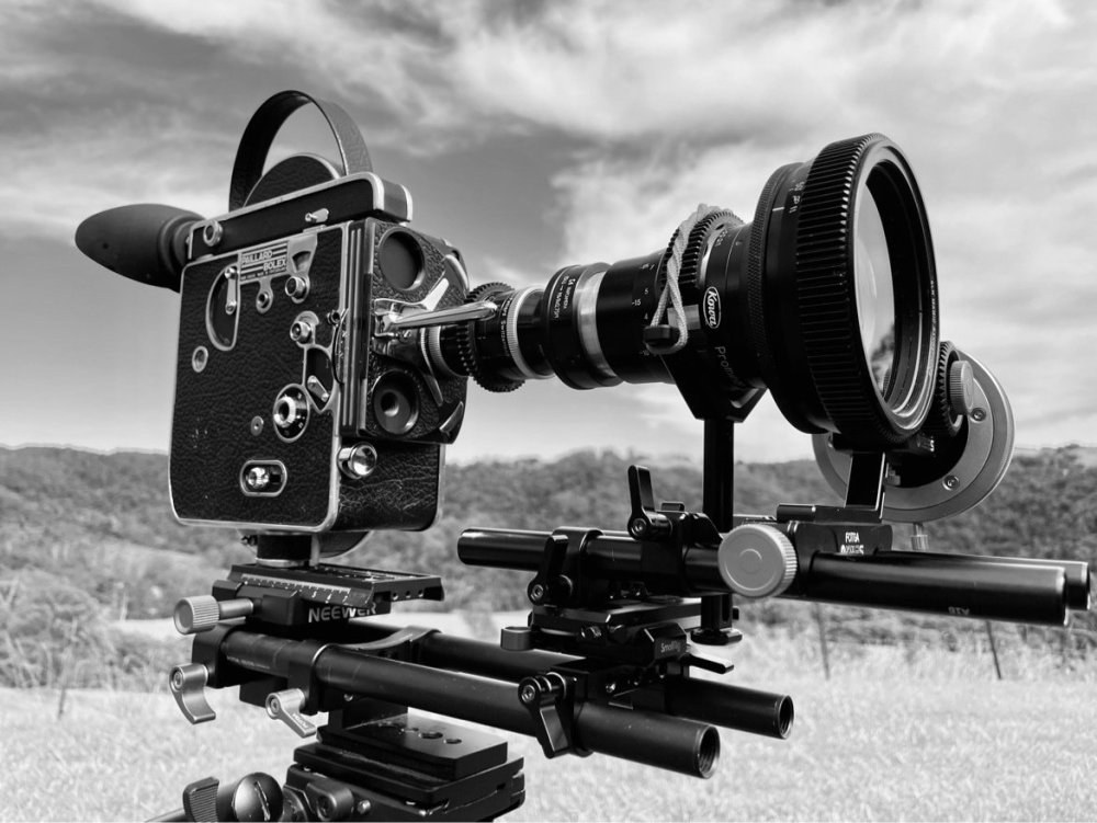

Bill Hunt Posted January 16, 2025 Author Posted January 16, 2025 My new baseplate arrived yesterday—so I rebuilt the whole contraption. Now with two supports the weight of the lenses is completely off the c-mount. I’ve taken a lot of time to get the alignment right. The bands you can see holding the lenses to the supports are made from pneumatic inner tubes. They were initially a work-around, but they work so well in keeping them—and the rest of the tube, for spares. One thing I’ve come to rely on in terms of getting the alignment right is a very simple test; when the anamorphic/diopter lenses are aligned correctly with the taking lens the focus ring on the taking lens rotates quite freely. Any slight misalignment and the focus ring grabs and is more difficult by degrees to turn. Simple in practice, but it took me a while to figure it out. Turret lock on the way from Do-All as well—just for safety.
Bill Hunt Posted January 16, 2025 Author Posted January 16, 2025 45 minutes ago, Bill Hunt said: P.S. Although it looks kind of weird, the two tiered rails incorporate a sliding clamp that initially allowed me to align the top rails with the (offset) lens. It started out as a work-around due to me not having a proper Bolex baseplate, but it worked so well I’ve kept it.
Bill Hunt Posted January 16, 2025 Author Posted January 16, 2025 7 hours ago, Don H Marks said: Could you tell what lens you are using. I recognize the Yvar 75mm , but can't find on the "SLR Magic" website the lens combination. Hi Don, Dead-on with the Yvar, then there’s a couple of (Rafcamera) adapters, Kowa 16s, more adapters, SLRMagic “Rangefinder”—which I believe you can only find second-hand now.

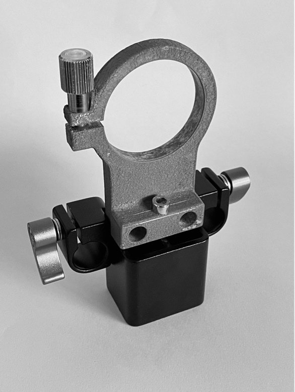

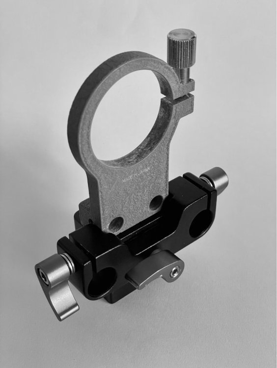

Bill Hunt Posted January 21, 2025 Author Posted January 21, 2025 I bought another Kowa 16s anamorphic lens last week with the thought that if I had two, I wouldn’t have to swap my single lens between the camera and projector—yes, I’m lazy. When the 16s arrived in the post it was beautifully packaged, but the lens itself was in very poor condition indeed. We’ll leave the lens for now… What came with the lens however was a clamp. Quite well made, alloy, and in reasonable condition. To cut a long story short, I dismantled another rig I had set up so I could have the height adjustable baseplate clamp, removed the clamp, drilled a hole in the base of the lens clamp… and Bob’s your Aunty’s husband, as they say. As I’ve mentioned, the previous setup was solid and worked well, but there was one problem; when the Kowa (the other “good” one) was attached to my 25mm Kern there was a slight vignette which may not have been noticeable to the casual observer—but would have driven me nuts. With this clamp attached to the rear of the Kowa I don’t need the previous screw-on adapter. This will allow me to set the Kowa somewhat closer to the taking lens and (hopefully) solve the vignetting issue. I plan on making a collar to stop light leaks. The other advantage of this set up is changing the taking lens with be much easier; slide the whole assembly forward, swap taking lens, slide back into place. Let’s see if it works…

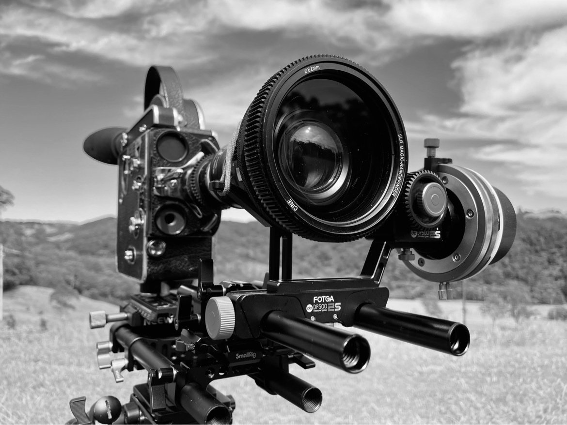

Bill Hunt Posted January 31, 2025 Author Posted January 31, 2025 Here’s the latest, loaded with Kern 25mm which seems vignette-free thanks to the new clamp—see previous post. The motor runs off a lithium 24v battery. I used old style two-pin microphone plugs for looks mainly, but they are very sturdy and reliable as well. They’re not unlike the Tuchels used on Nagra decks, although nowhere near the same quality. As you can see, the turret lock arrived—in very good condition too. Just after I took this photo the rain started bucketing down…
