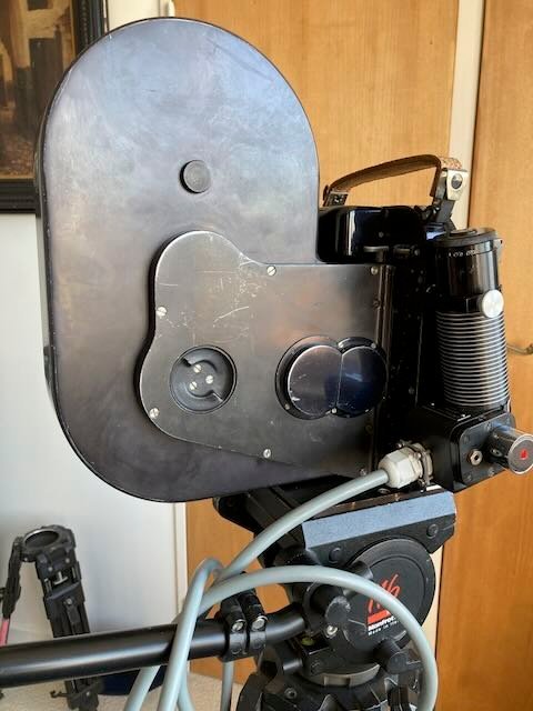

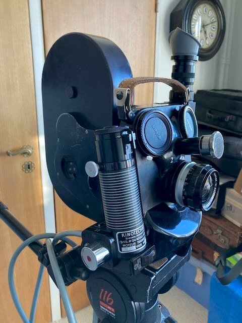

Craig Boydston Posted April 29, 2025 Posted April 29, 2025 I've only ever heard about this model of CM3, I would love to see a photo of what they actually look like. If you don't mind sharing your build.

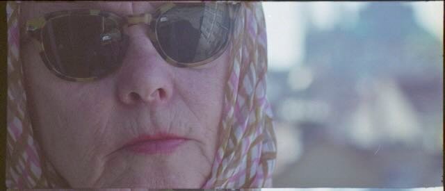

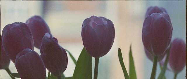

Premium Member Steven Jackson Posted April 29, 2025 Author Premium Member Posted April 29, 2025 Sure, I'll post a few photos and a screen grab from some film I shot with it.

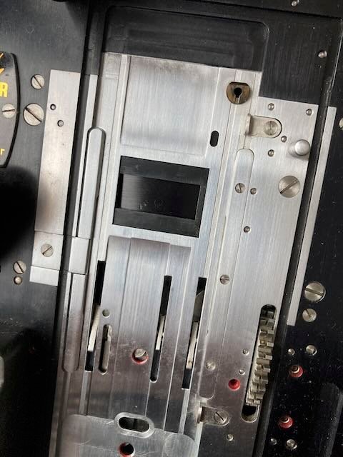

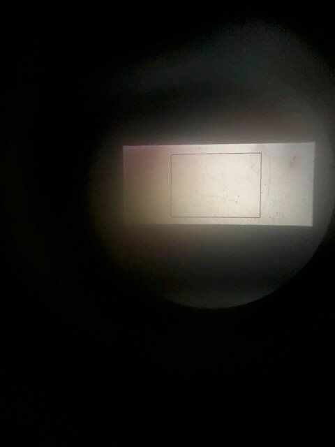

Premium Member Steven Jackson Posted April 29, 2025 Author Premium Member Posted April 29, 2025 You can see below the claws there is an oval shaped hole--this is for changing the 35mm claw travel from 2 or 4 perf (Only the 2 perf cameras have this, so an easy way of distinguishing them from other Cameflex cameras). The main magazine drive gear, however, does not change speed so you need the special Cameflex magazines (notice the two bumps on the motor side of the magazine which houses the reduction gearing) that allows the film to turn at 2 perf. Those gears are reversible and the camera and magazines can be switched to run at 4 perf, too. The viewfinder comes with a factory mounted ground glass mask for 2 perf which can be removed. The film gate 2 pef mask slides into the filter slot. As it happens, I received this camera in almost new condition. I doubt very much film, if any, was ever shot through it. The image is amazingly steady judging from the tests I've done so far. There were a few people who did aftermarket conversions to 2 perf which involved changing the gearing within the camera, but as far as I know those are not capable of being swapped over to 4 perf but they are able to take standard magazines.
Premium Member Steven Jackson Posted April 29, 2025 Author Premium Member Posted April 29, 2025 9 hours ago, Craig Boydston said: I've only ever heard about this model of CM3, I would love to see a photo of what they actually look like. If you don't mind sharing your build. here you are.
