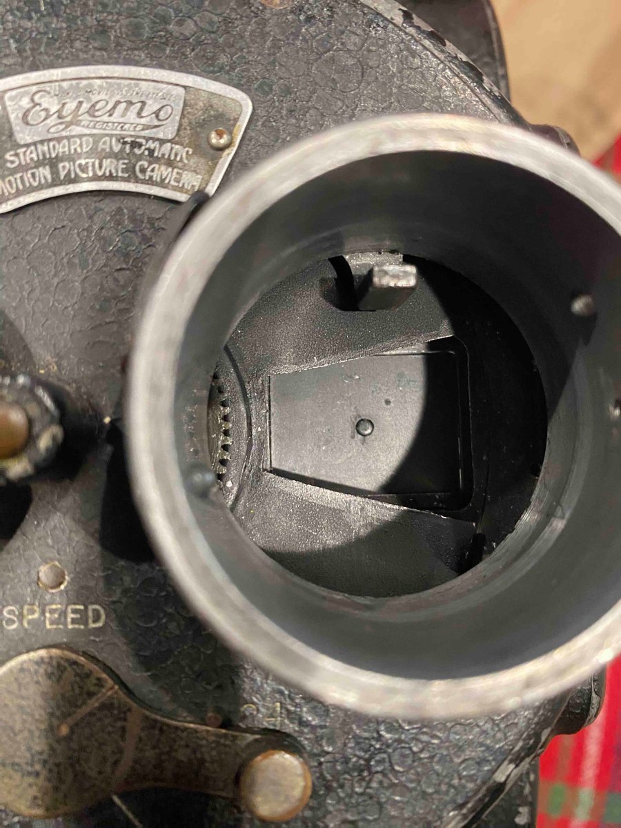

Aaron Martin @ OH Posted February 1, 2025 Posted February 1, 2025 -- it's very narrow, whatever it is, and I am not sure how many stops to open up to correct for it. Looks like someone put a disk behind the original shutter to create this pizza slice. Aaron

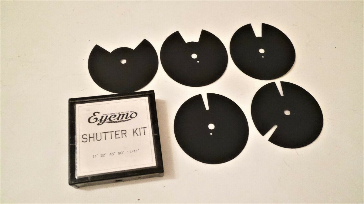

Premium Member Simon Wyss Posted February 2, 2025 Premium Member Posted February 2, 2025 22 degrees The Eyemo could be had with various shutters.
Nicolas POISSON Posted February 2, 2025 Posted February 2, 2025 (edited) Measuring your image in Gimp gives an angle of 26°. But the perspective is making this measurement wrong. The photo should be taken right in front to avoid this. By the way, what's the purpose of the dual "11 /11" shutter ? Edited February 2, 2025 by Nicolas POISSON
Aaron Martin @ OH Posted February 2, 2025 Author Posted February 2, 2025 8 hours ago, Simon Wyss said: 22 degrees The Eyemo could be had with various shutters. Thank you very much for answering my question. So, am I correct that the 22 degree shutter is a disk placed behind the original shutter and can be removed leaving the original 165 degree shutter?
