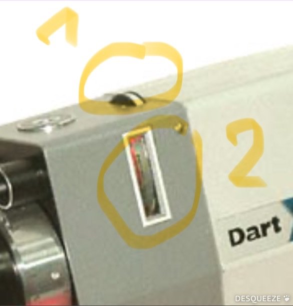

Jack Thomas Posted April 18 Posted April 18 I'm looking for anyone who has information on this specific model, or who has knowledge of the components which I suppose should probably have been reused across the Chinon line. I was recently gifted this camera and I'm keen to understand as much as I can about it, to hopefully replace some parts but also to better shoot some tapes on it. There are two things I'm mainly curious about: 1) It has a selector to switch between auto and manual, but no controls to actually manipulate exposure with, that I can see anyway... It also simply says in the manual that exposure is selected automatically and refuses to elaborate! 2) The viewfinder is really interesting, what I originally thought was a missing part seems to in-fact be the default rubber eye (rest?) which is tiny with the internal diameter at just 11mm and the external diameter at 22mm. I thought it had perhaps originally come with a larger eye cup which slid over the attached one but all the promotional images and the front of the manual don't reflect that. I want to identify a replacement eye cup or some kid of attachment which would make looking through the viewfinder more comfortable, but also I want to understand how the assembly works, it appears to be a lens inside a long tube that screws into the camera body, with threading that runs the entire length of it, with a small rubber cup on the end that protrudes. This small rubber cup (which you should be able to see if you look at an image of the camera online) appears to have been attached but I think due to age the rubber has degraded and while it does slip on to the tube part, nothing is holding it in place. If anyone has experience with this camera (or I suppose any of the other Chinon Dart line as I would assume there would be similarities), I'd love to learn more about it, I don't have the camera with me at the moment but I'll take some photos of the parts and upload them when I get a chance. Thanks!
Joerg Polzfusz Posted April 19 Posted April 19 Hi! Your Chinon looks like several other „Darts“, but it completely differs from the two „Dart 70“-models and the „Dart“ without any numbers: https://www.filmkorn.org/super8data/database/cameras_list/cameras_chinon/cameras_chinon.htm However, all of them are film cameras, so they can’t be used to shoot tapes. Not really sure about the manual exposure. I would assume that you simply turn the dial 1 and control position of the needle at 2. Good luck!

Jack Thomas Posted April 22 Author Posted April 22 (edited) @Joerg Polzfusz Apologies it took some time to reply! Thanks for the info, I had another look and it seems like you were correct and the manual/auto dial does in fact change the needle position, so it looks like I could potentially manually control exposure if I was feeling confident enough. Out of curiosity, as this is all new to me, what do you mean by 'they are film cameras so they can't be used to shoot tapes'? Edit: AH! I see I referred to the film 'cartridge'? as a 'tape' my mistake 😅 Also, any advice on tracking down a solution for the eye cup or more info on the viewfinder assembly? Cheers Edited April 22 by Jack Thomas
