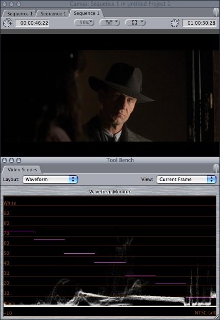

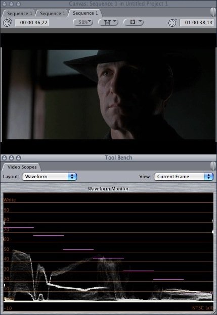

Premium Member Michael Nash Posted November 1, 2007 Premium Member Posted November 1, 2007 If your scene is dark, then it should look that way on the waveform. A dark or low-key scene will have a majority of the waveform filled with luminances well under 50%, punctuated by brighter areas. (Stills from Slow Burn, photographed by Wally Pfister, ASC) Remember that the display gamma of many monitors (especially CRT's and plasmas) is not linear, but pushed upwards quite a bit. That means that 50% luminance will often look much brighter on the display than you would think, and shadow areas will show much darker on the waveform than you might think based on viewing the monitor image.

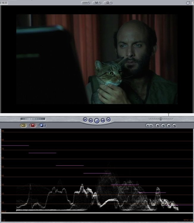

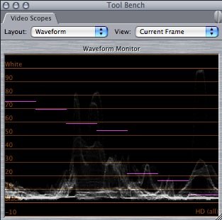

Premium Member Michael Nash Posted November 2, 2007 Premium Member Posted November 2, 2007 I realize those pics are perhaps a bit dark to begin with, so here's a more realistic example. These stills are from the DVD of Dark City, played on my Mac with custom AV settings that make my monitor closely emulate the look of my CRT TV. I screencapped the images and brought those into FCP (there's a slight gamma adjustment applied to images imported into FCP, so these luminances aren't completely accurate, but close enough for demonstration). Here in this somewhat dim scene the face is about 40%. Note that in this scene because of the dark background, skintone that is close to "properly exposed" actually looks quite bright in the scene. Here it's actually a touch under, between roughly 55%-65% If you go in tight on the keyed part of the face and replace the dark BG with a 50% luminance border, you can see that the skin tone is close to properly exposed, about 1/3 stop or so under, peaking around 65% instead of 70+%

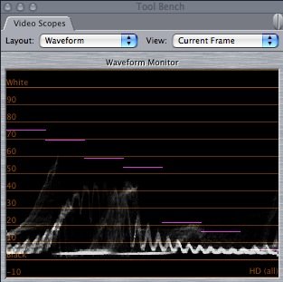

Marc Levy Posted November 2, 2007 Author Posted November 2, 2007 Michael, thanks for the above demo. It's very useful. I feel a cool wave of relief now, as the waveform images you posted are close to what I've been staring at for the last week on this shoot. I just got a frame grab of one of the shots I was concerned about. It's an H264 compressed file from the editor, but here it is:
Premium Member Michael Nash Posted November 2, 2007 Premium Member Posted November 2, 2007 It is a dim scene, and on the waveform it looks about like you would expect. Hand peaking about 45%, face peaking about 35%. Think of it this way: if the scenic content weren't below 50%, it wouldn't look dark, now would it? Looks good. HPX500, you say? How would you compare the images to those of the HVX200?
