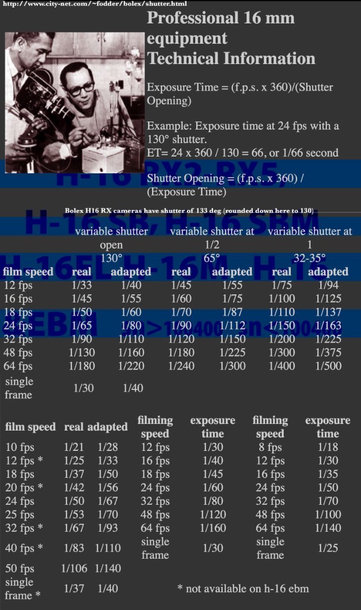

David T. Nethery Posted July 9 Posted July 9 (edited) On 5/27/2010 at 7:39 PM, Richard Tuohy said: When using a reflex bolex, the simplest thing to do is to use the cine speeds on your light meter and make the exposure correction with the asa setting. This way, you can readily switch between shooting speeds without having to re-calculate anything. The correct compensation is 2/3rds of a stop in total, which includes 1/3rd of a stop for the 130 degree shutter angle, and 1/3rd of a stop for the prism light loss. Thus, if you are using 100 asa film stock, set the light meter to 64 asa (which is 2/3rds of a stop slower than 100 asa) then simply set the meter to 24fps if you are shooting at 24, or 12 if shooting at 12 etc.. Here is a chart that puts this correction in terms of real and adapted shutter speed: http://www.city-net.com/~fodder/bolex/shutter.html But as I say, I prefer to adapt the asa rather than the shutter speed. richard The link http://www.city-net.com/~fodder/bolex/shutter.html is to a website that is no longer active , but can still be viewed (for now) via the Internet Wayback Machine (archive.org) . For anyone now or in the future researching this topic , I have attached a screen capture of the chart showing the real and adapted shutter speeds that Richard Tuohy was referencing above. However, the suggestion to simply use a standard light meter in Cine mode (which assumes a 180 deg. shutter) and compensate for the Bolex RX 2/3rds light loss (through the prism and for the Bolex RX shutter angle) by adjusting the ASA of the film stock by 2/3 is the easiest solution. Edited July 9 by David T. Nethery
