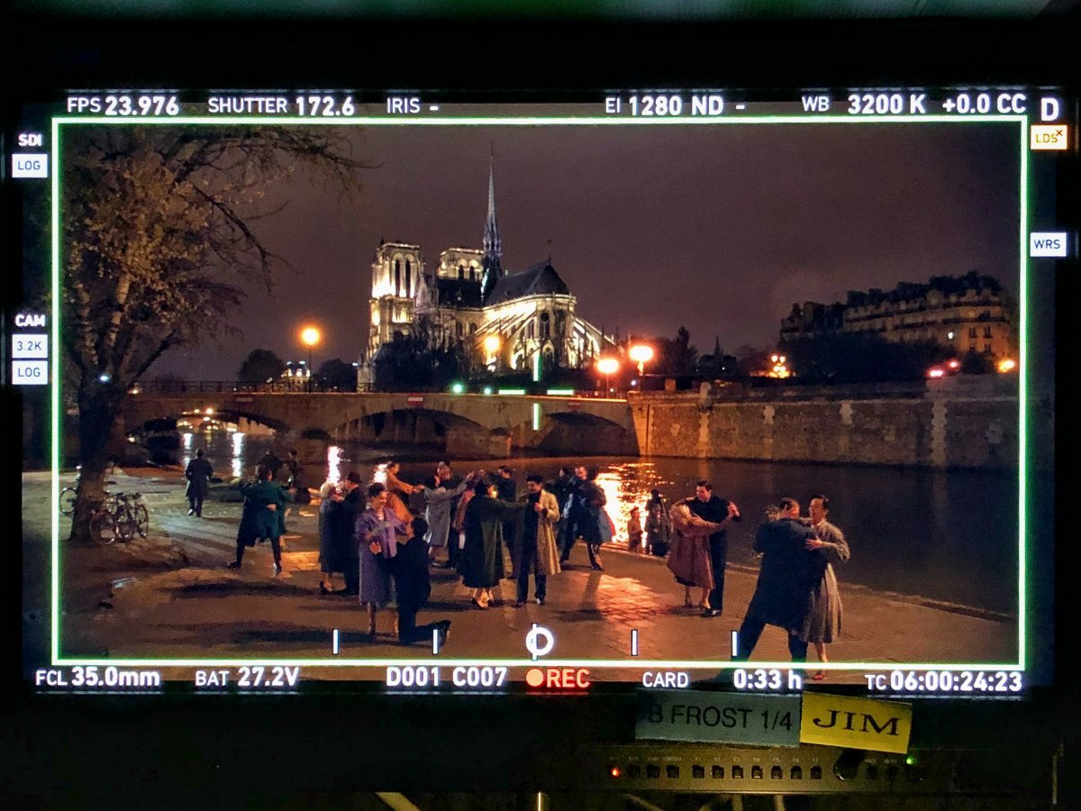

Premium Member David Mullen ASC Posted August 30, 2024 Premium Member Posted August 30, 2024 Here is a frame grab of a monitor when I was filming in Paris back in 2018. We always used 23.976 fps / 172.6 degrees when we were there. In a 60 Hz country at 24 fps, you would use 180 or 144 degrees, 180 degrees is within an acceptable window for many pulsing AC discharge lamps but 144 degrees is technically the correct shutter angle to get a 1/60th shutter time. 1
