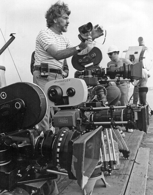

Kris Kaspian Posted April 18 Posted April 18 (edited) Sorry to revive this decade-old thread, but the discussion is still relevant: I'd love to know what focal-lengths were mostly used for Alien (1979), and this was never established. I want to get a feel for anamorphics used wisely. I'm planning to shoot on a fully-enclosed four-wall practical set with integrated practical lighting and low ceilings (which was also the situation with Alien). My concern regards how much room to advise the set-designer to provide inside; making the set as claustrophobic as possible, while leaving enough room to frame shots. I intend to shoot anamorphic. Could anyone here offer their expert-opinion (or best-guess) on what focal-length of anamorphic was used for the shot below? I know from the August 1979 issue of American Cinematographer that the set for the Nostromo in Alien was "designed in such a way that we were able to take out at any time large sections of walls... although we tried to avoid doing this". So I'm curious about whether most of the movie was shot with wider anamorphic lenses? I was also interested in anyone's best-guess about this frame from Alien, again specifically regarding the focal-length of the anamorphic lens used. Is it the same one as the previous shot? Also: Are we looking at Panavision C-series anamorphic primes? If you were pushed to name the two most-used anamorphic focal-lengths on this production, which would you pick? Thanks! Edited April 18 by Kris Kaspian Formatting

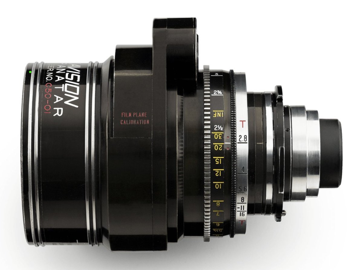

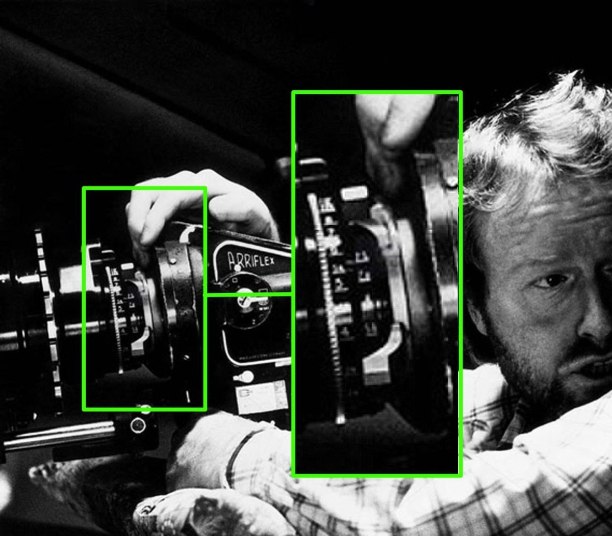

Kris Kaspian Posted April 19 Posted April 19 (edited) Update: I have been able to evidence, via a photograph, that Alien (1979) appears to have been shot using Panavision C-series anamorphic lenses. Here is a picture of Ridley Scott operating a camera on the Alien set (I have enlarged the lens markings). Can anyone confirm the mounted lens is a match for one of the C-series? A comparison lens (a 50mm; not an exact match) is also pictured below for reference. Strangely, I could not find any photographs of the other focal-lengths available from Panavision for this lens-type. There doesn't appear to be a physical-catalog containing any photographs, or any online-photos of the entire lens set with legible markings. Photographs of the 50mm is basically all that exists online. [Source: Panavision] The only known statement regarding the technical details of the lenses used on Alien comes from David Johnson BSC, who told British Cinematographer magazine that "The film stock was 100 ASA Kodak 5247 and the lenses were wide open at T2.3.-2.8.". [Source: British Cinematographer] Only the 35mm and 50mm panavision offer T2.3. So we can deduce that one or both of those were among the lenses used in Alien. Does anyone here know the Panavision C-series well enough to determine what Ridley Scott has mounted on the camera in the first photograph? Markings on Scott's lens show T2.5, which means it can only be the 75mm; right? No other C-series has that as its widest aperture. [Source: Panavision] Any expertise in this area is greatly appreciated. Thanks! Edited April 19 by Kris Kaspian spelling

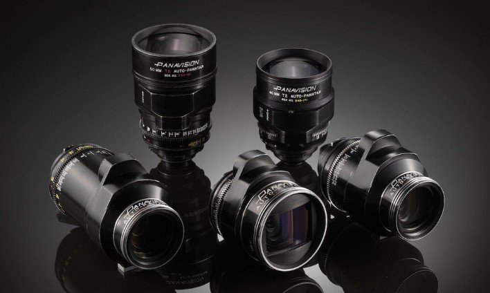

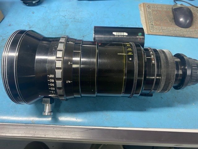

Premium Member Dom Jaeger Posted April 20 Premium Member Posted April 20 Here are some more C series: None look like the lens in your image, or in some other bts shots I've seen. A C series giveaway is the protrusion on the top for the astigmatiser gear. Actually all older Panavision anamorphics have it. There is a distinctive knurling in that bts lens which is something found on older spherical lenses like Super Speeds and Ultra Speeds, as well as some zooms. But many lenses have been refurbished over the decades so maybe that knurled "hand focus" grip used to be on some anamorphics too. This lens pops up a bit, which is longer than any C series, it could be a Panavised Cooke 20-100 with an anamorphic back, making it 40-200. 1
Premium Member Dom Jaeger Posted April 20 Premium Member Posted April 20 This looks like the same lens. 1
Premium Member Dom Jaeger Posted April 20 Premium Member Posted April 20 Here’s an anamorphic Cooke 40-200 with a similar knurled focus ring.

Premium Member Dom Jaeger Posted April 21 Premium Member Posted April 21 16 hours ago, Kris Kaspian said: The Panavision 50-500mm anamorphic-zoom does add some ambiguity because (as Dom deciphered earlier in this thread) this zoom may have been a Z10A 50-500mm T5.6 Super Panazoom (technically a Cooke-based spherical zoom with Panavision anamorphic adaptation) Or it may have been an Angenieux Panavision Zoom Anamorphic (APZA). Or it may be another Panavision zoom with a very similar range. It's a bit hard to tell but I suspect it may have been the 50-500 Super Cine Varotal Cooke, based off the Mk1 25-250 which would have been pretty new in 1979 (released in 1975). The older, Angenieux based 50-500 looks different I think. Here's a shot of it being used for the famous Jaws dolly zoom in 1974: Here's another Jaws BTS photo showing both a couple of thos zooms and a C series anamorphic sporting what looks like a matte box with that distinctive zebra knurling. You can tell it's a C series by the astigmatiser gear hump on the top of the lens that I mentioned previously. 1

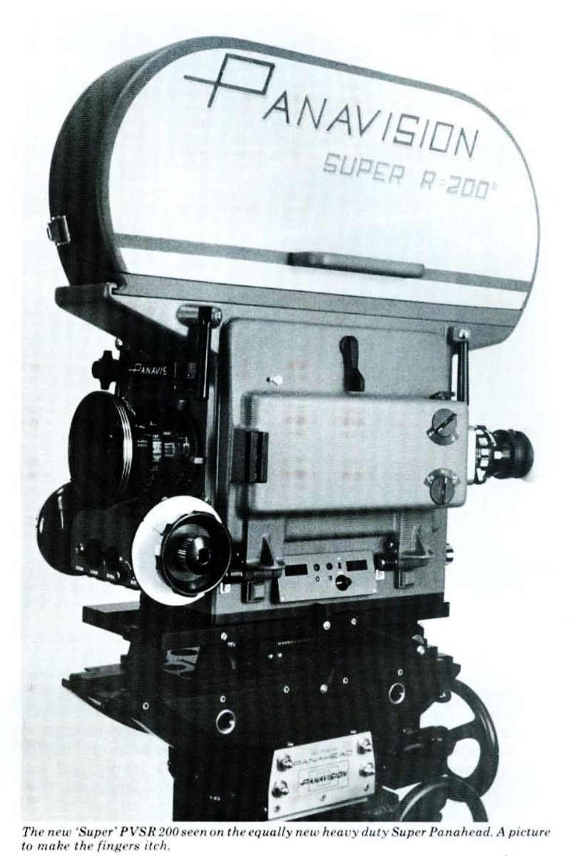

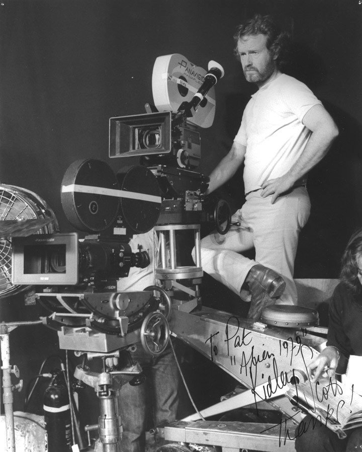

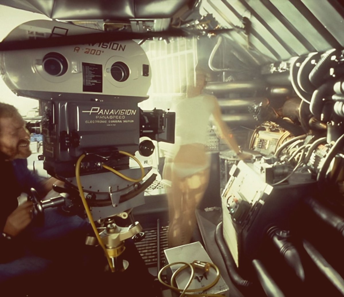

Kris Kaspian Posted April 21 Posted April 21 (edited) 3 hours ago, Gerard Dalton said: ...wondering why would Scott prefer to use zoom lens? What advantages or special quality did they give him specifically in his films? Good question. On Alien, a member of the original crew confirmed for me that Scott used a Panaflex (often in handheld mode) as the 'A' camera, pictured here: Then a Panavision PVSR was used as the 'B' camera on Alien. It was this camera that was used if zooming was required in a shot. Incidentally, there is hardly any zooming-in in Alien. Here's a catalog shot of this Panavision PVSR, for historical reference. The glorious antithesis of run-and-gun: Catalog Source: Panavisions of the Future Apparently Scott's affinity for zoom lenses is not because he likes to zoom-in, during a shot, but is on account of speed-of-setups. It's funny, but Scott just doesn't worship at the altar of primes, although (arguably) his best work was mostly shot with them. This from an interview, years later, with John Mathieson BSC regarding the approach on Gladiator (2000): Quote ...you better make sure you don’t muck people around by trying out different lenses. “Put the zoom lenses on and we’ll get what we need. It might sound callous, but you’re under pressure... Two sets of Panavision T1.4 Panaspeed primes were added into the mix, “but rarely came out as it’s all about the zooms with Ridley, because you have to move onto another set-up quickly,” says Mathieson. Source: British Cinematographer Edited April 21 by Kris Kaspian
Kris Kaspian Posted April 21 Posted April 21 2 hours ago, Dom Jaeger said: It's a bit hard to tell but I suspect it may have been the 50-500 Super Cine Varotal Cooke, based off the Mk1 25-250 which would have been pretty new in 1979 (released in 1975). Thanks for the great detective work! That's probably it, maybe 'Panavised' in some way.
Premium Member Dom Jaeger Posted April 21 Premium Member Posted April 21 (edited) 16 hours ago, Kris Kaspian said: Thanks for the great detective work! That's probably it, maybe 'Panavised' in some way. Oh they were definitely "Panavised", with completely new housings. Panavision liked to standardise the focus rings at the back of the lens, so they added a rear focus ring with external gear drives and also changed the focus, zoom and aperture ring scales, since the 2x anamorphic adapter at the back changes all those marks. Some were also modified to be remotely motor driven. The mounts were also changed to PV mount. Later on, the Mark II Cooke 25-250 Varotal was actually released in two variations, one "Panavision style" with a rear focus ring. Edited April 21 by Dom Jaeger 1
