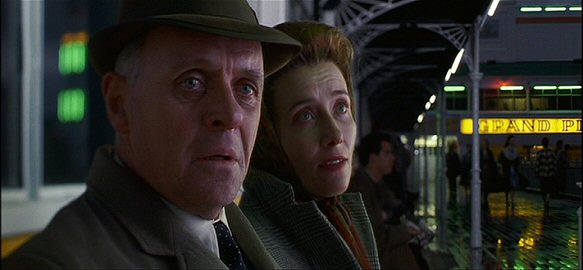

Boris Bergshoeff Posted March 12, 2017 Posted March 12, 2017 Hi guys and girls, I have just watched The people vs OJ Simpson, in just three days. I liked it a lot, especially the cinematography.I have a question about one of the shots i saw, Two people in the shot, one in close-up and the other in a chest shot (so there's distance), both of them are in focus but the background isn't. Is this deep focus or is it compisited?Thanks!The people vs OJ Simpson ep.10
Premium Member David Mullen ASC Posted March 12, 2017 Premium Member Posted March 12, 2017 Just looks like deep focus (stopped down lens) though it may have been helped by using a tilt-focus lens in conjunction with stopping down. He's a little out-of-focus here so it is unlikely to have been a composite shot.
Boris Bergshoeff Posted March 12, 2017 Author Posted March 12, 2017 Just looks like deep focus (stopped down lens) though it may have been helped by using a tilt-focus lens in conjunction with stopping down. He's a little out-of-focus here so it is unlikely to have been a composite shot. Thanks! I thought about that too but i don't know the exact behavior of a tilt shift lens.
Premium Member David Mullen ASC Posted March 12, 2017 Premium Member Posted March 12, 2017 Here is an example: Here is something I shot: The focus falls on a diagonal plane rather than flat onto the camera plane, so one edge of the frame is at minimum focus and the opposite edge is at infinity. But the more you stop down to increase depth of field, the more you help the deep focus effect.

Premium Member David Mullen ASC Posted October 12, 2017 Premium Member Posted October 12, 2017 I don't think the frame from the original post used a split diopter filter because the split would have been seen in her shoulder. As for the history of deep focus, the earliest use of a split diopter filter that I can find is from the mid-1950s though there is no reason why it couldn't have been invented and used much earlier, I just can't find any examples or mention of them before the 50s. 1
