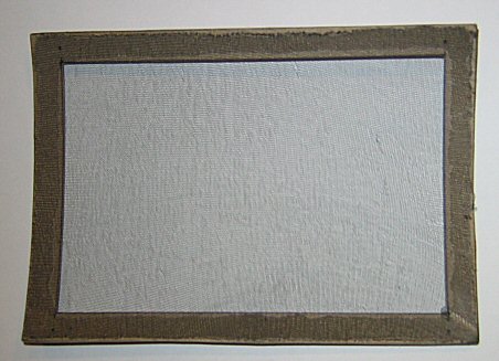

Guest Christopher Wedding Posted July 11, 2005 Posted July 11, 2005 Mr. Mullen, You mentioned a 'home made net' earlier in the post. How do you make such a thing, what sort of material do you use? Also, how does it soften an image and are there any rules of thumb or tricks of trade when using stuff over the lens, i.e. better for longer lenses or wider lenses at wide open...etc? I know these questions are broad, but any insight is appreciated. Thanks for your continual help in theses forums. Also, are there any stills of the final product? Best, Chris
Premium Member David Mullen ASC Posted July 11, 2005 Author Premium Member Posted July 11, 2005 I cut some frames out of heavy chipboard, like on the back of a notepad. I slightly made them oversized, stretched the black pantyhose over the frame and carefully used a stapler to staple it down all around (you have to be careful while stretching because the staple can cause a run.) The staples were along the excess edge that I planned on trimming off. Then on the inner edges, I rubbed white glue over the net where it touched the cardboard. When it dried, I trimmed off the excess edges containing the staples. The chipboard has to be thick or else it curls from the net stretched tight over it. But too thick and it's hard to cut with an x-acto knife. The black pantyhose should be the most Ultra-Sheer you can find. I made two, one with a more uniform cross-cross weave which is a lighter diffusion but a more obvious star filter effect. Then I had one with a heavier and more complex weave pattern resembling more of a honeycomb when stretched out. I just took these photos, first two are of the cardboard filters (4x5.6). The last three are of a candle flame, one with no filter and then the next two with the two different nets. The wider-angle the lens or the more stopped down you are, the more you risk seeing a front-mounted net filter pattern come into focus due to the depth of field, especially with DV.

Jonathan Bryant Posted July 15, 2005 Posted July 15, 2005 David, How does black pantyhose differ from say a Black Pro Mist filter? My boss has used panty hose alot between the lens and camera though it always gets strange looks.
