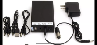

Eric T. White Posted January 4 Posted January 4 I found this listing for a 12v battery on eBay. Seems like a good match for an Arri SR. Anyone have experience or thoughts on this? https://www.ebay.com/itm/171567985013?mkcid=16&mkevt=1&mkrid=711-127632-2357-0&ssspo=CPZDTTbtQSK&sssrc=4429486&ssuid=Q48Z3YQOSqS&var=&widget_ver=artemis&media=COPY
