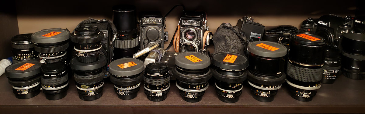

Premium Member David Auner aac Posted May 3, 2020 Premium Member Share Posted May 3, 2020 Hi guys, Webster asked me to post a pic of my "lens shelf" 🙂 as he calls it. It's an IKEA cabinet with glass doors. When they're not in the Peli my glass lives there. But mind you I live in LA so humidity isn't an issue usually... Best, David 2 Quote Link to comment Share on other sites More sharing options...
M Joel W Posted May 4, 2020 Author Share Posted May 4, 2020 Thanks, David. I do worry since I live in an area that's more humid than LA. Is a humidity controlled locker better or worse than a sunny shelf? I assume it depends on humidity levels. What's the concern with just storing in Pelican cases? I assume if there's desiccant fungus won't be a problem? How are lenses stored at rental houses btw? Quote Link to comment Share on other sites More sharing options...
Premium Member David Auner aac Posted May 4, 2020 Premium Member Share Posted May 4, 2020 Yeah it all depends. Where are you located? Most rental houses store them in their flight cases, but they also have quite controlled environments usually. So if you can have a humidity controlled locker that would be ideal. And well, the thing with Pelicases is that they're (almost) airtight and if it is humid in there it will stay that way and provide a good environment for fungus to grow. Quote Link to comment Share on other sites More sharing options...
