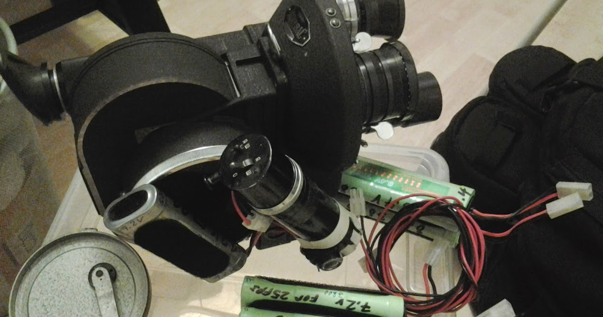

Premium Member Aapo Lettinen Posted June 17, 2020 Premium Member Posted June 17, 2020 the easiest way to power 8v camera motors is to use Airsoft / RC Car nimh batteries which have tamiya connector. These can be got in 7.2V and 8.4V and it is very easy to make a adapter cable which connects to your camera. You can get additional chargers easily and as many batteries as you want and they are affordable. (if getting extra batteries, make sure to regularly keep them charged to avoid them going bad. High capacity low quality batteries tend to self discharge quicker than good quality low capacity ones.) I would keep the battery belt just the way it is and just get couple of the 8.4v airsoft batteries and a charger. you can make your own belt clip for the batteries. I like to use velcro for mounting them to the side of the camera

Premium Member Aapo Lettinen Posted June 17, 2020 Premium Member Posted June 17, 2020 2 hours ago, steven jackson said: I just thought it might be possible to install a switch into my battery belt that would convert it to 8v or 12v, which is how some of the battery belts for arriflex were supplied. it would be easy to install that type of switch as long as the switch can stand the current requirements. It will make charging the belt a little more complicated though if you discharge it at 8v but then want to charge at 12v so that some of the cells are full when the others are near empty. I would maybe use a separate 8v charger in that situation and only charge the drained cells (keeping the switch at 8v position when charging)
