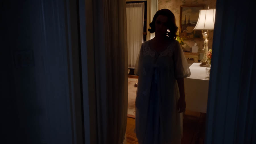

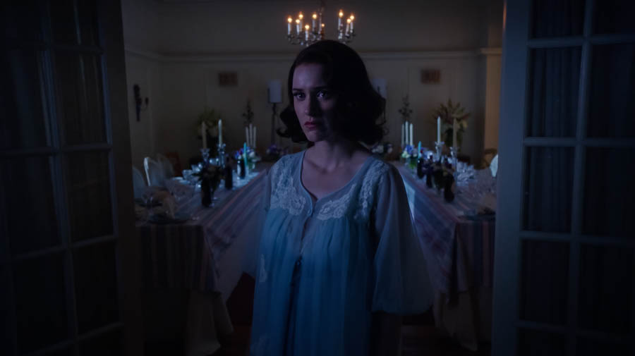

Premium Member David Mullen ASC Posted September 20, 2020 Premium Member Posted September 20, 2020 I light a moonlit interior more or less the same as a daytime interior, the light comes through the window, etc. White walls are very tough to deal with, it's always best to avoid them unless you are going for some very stark, white room effect in moonlight and people are more or less in silhouette against the walls. Otherwise, I'd use harder moonlight so that it only falls where you want it to fall. I had a scene in the pilot of "The Marvelous Mrs. Maisel" where Midge comes back into her apartment and is confronted by the set-up in the dining room for big dinner party; it's a sad scene but I needed to see the dining room table setting and her reaction in the dark, so I played the "moonlight" a bit stronger to see everything. The camera pulls back with her from the foyer with the lamps on into the moonlit living room / dining room: Even though we built this apartment for the series, for this pilot, this was a real apartment in NYC so it was a bit of a pain to get the moonlight effect through the dining room windows in the background because we were on the 4th floor and the street outside the window was not level. Once we rebuilt this for the series, it was easy to shine a light through that window! 2

Stuart Brereton Posted September 20, 2020 Posted September 20, 2020 6 hours ago, David Mullen ASC said: I had a scene in the pilot of "The Marvelous Mrs. Maisel" where Midge comes back into her apartment and is confronted by the set-up in the dining David, can you recall your setup for the foyer part of the shot? Was it just the two table lamps, or is there a soft fill source in there as well?
Premium Member David Mullen ASC Posted September 20, 2020 Premium Member Posted September 20, 2020 Just the table lamps -- I had the art department add the one by the door because earlier we had a Steadicam shot that started in the bedroom and went down the hallway into the foyer and then landed on her face as she shut the front door and put her back against it, and I didn't want the overhead foyer light on and we saw most of the foyer ceiling when the camera started down the hallway, so I needed a lamp right next to the door. Plus that's a glass door with sheers over it, so any eye level lamp would have gotten reflected in it. This is where the Alexa really shines, when the lampshades have to do the actual lighting too and you don't want clipping.
Mitchell Priebe Posted September 20, 2020 Posted September 20, 2020 13 hours ago, David Mullen ASC said: Even though we built this apartment for the series, for this pilot, this was a real apartment in NYC so it was a bit of a pain to get the moonlight effect through the dining room windows in the background because we were on the 4th floor and the street outside the window was not level. Once we rebuilt this for the series, it was easy to shine a light through that window! Do you recall the type of light you were using for these shots? Also did they have gels on them to give that steel blue color?
Premium Member Satsuki Murashige Posted September 20, 2020 Premium Member Posted September 20, 2020 14 hours ago, David Mullen ASC said: Even though we built this apartment for the series, for this pilot, this was a real apartment in NYC so it was a bit of a pain to get the moonlight effect through the dining room windows in the background because we were on the 4th floor and the street outside the window was not level. What was the trick for getting the HMI outside the window on the 4th Floor? Scaffolding? Or an extra tall condor? Adjacent building?

Premium Member David Mullen ASC Posted September 20, 2020 Premium Member Posted September 20, 2020 Thanks Jarin -- that's something I've learned too -- if your key is going to end up, let's say, 2-stops under in the final shot for moonlight and the shadows go to near black at 5-stops under, then you basically have to have your fill only 2.5-3-stop under the key if you want detail. So to your eye, it seems a bit low-contrast on set. Satsuki, I seem to recall using a very tall condor but it took a lot of leveling. On her face, I think it was a daylight Litemat with a soft crate plus some flags.
