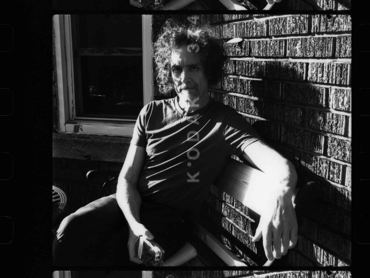

Roy Cross Posted June 8, 2021 Posted June 8, 2021 Hi, I shot some Eastman 2374. I thought my stock was old enough that there wouldn't be edge numbers down the middle of the frame, but I was wrong. I also have some 2378. Does anyone know if Kodak did the same with the 2378? I guess I can pull a strip and process it but though I would ask. Thirty years ago a shot a few thousand feet of Agfa ST8 in 16. Loved it. Anyone know if that can be found in 35mm anywhere? I am working on a project and would like to shoot some fine grain, high con stocks. Any suggestions are appreciated! Roy in Montreal

Roy Cross Posted June 10, 2021 Author Posted June 10, 2021 (edited) Full shade, 2374 Edited June 10, 2021 by Roy Cross
