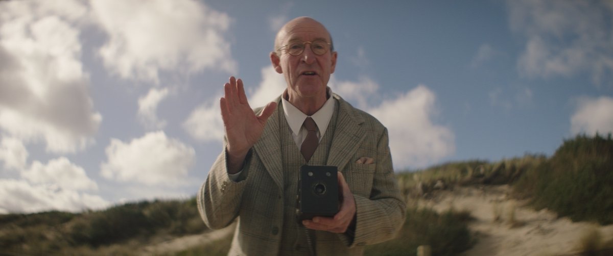

But here are a couple of samples (Video Village do a "lite" version of the plugin which is free, and can be used on footage up to 1080p in resolution, it just gives you a single, full S16mm and S35mm preset, with no adjustability of the various parameters). These are the same shots with just an Arri Rec709 LUT applied, and then Filmbox's S16mm emulation from the Lite plugin applied (no other adjustments):
Untitled_4.2.1.thumb.jpg.29e0512b87f02114c9fa5bf73deae337.jpgUntitled_4.2.2.thumb.jpg.65f774462c5f898ca47632a31a9fb853.jpg
Untitled_1_102.2.thumb.jpg.912db54b91916c54aec7dd5eda6256aa.jpgUntitled_1_102.3.thumb.jpg.517b656813be51a8d1feb88f0eba8053.jpg
Untitled_1_68.3.thumb.jpg.34dfe9383723471cdb0da6fbf0da60fd.jpgUntitled_1_68.4.thumb.jpg.3e9f5979c72889c65bad20895dd5df17.jpg
In motion, with the halation, grain, gate weave and occasional dust-spec applied. It's remarkably convincing.

It looks interesting! Thanks for posting this!
It seems to be doing at least some variation on what a lot of similar things do - contrasty cool shadows, low contrast warm highlights.
There's a point to be made about what modern film actually looks like, too. Modern camera negative is very low contrast because they were trying to compete on dynamic range, and they easily could. What that actually means is very, very flat, which of course is exactly what most people don't want when they go for film (or film emulation). It's also very often digitally stabilised, so it's very, very stable, and if you shoot 200 speed stock it's pretty low grain, and then you can degrain it - and that's before we even get to the point of being Christopher Nolan and shooting 5/65.
The better we do film, the less it actually looks like film. Which, of course, was always the point. Before we replaced film, its faults weren't cool.
