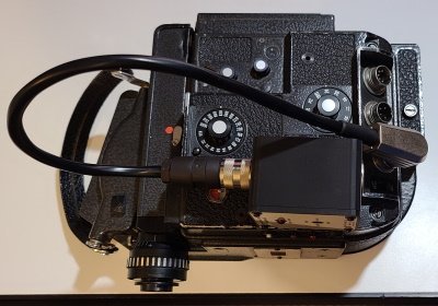

Marek Vesely Posted December 31, 2022 Posted December 31, 2022 (edited) Hey guys! I'm one of the Jason's customers from Europe and I've been using his crystal sync controller for my Super 16 Bolex EL since September! I've now shot over 4000ft of film in my 400ft magazines with his crystal sync and I just couldn't be happier with the product. I have the removable cable version of the sync box, custom made right-angle cable for the EL (also from Jason!) and I also made an acrylic side plate for my EL where I can just stick the box onto the camera with special 3M velcro tape. Really awesome setup! You can see it how it looks on this image: I've never had a single out-of-sync situation with Jason's box after these 4000ft of film! Not a single speed warning. I also own the original Bolex sync box for the EL and I had so many issues (I thought for a moment that my camera is broken) with keeping the motor at 24/25fps. It often ran much faster after 30 seconds of filming with the original Bolex sync-box. I shot this sort of a test-project / music video with my factory converted S16 EL and Jason's STL-24 crystal sync in September (all shot at 25fps because of practical lighting here in EU). This can give you an idea how well the crystal works. ? You can watch it in 4K right here: So at 300USD I think this is absolutely necessary piece of gear for EBM and EL owners when you basically can't get the original Tobin one nowadays. You can 100% rely on these on professional projects and film sets. Jason did not tell me to write this but I just wanted to let you know that these new STL-24 crystal boxes are out there and working on film sets! ? + Jason is just awesome to communicate with and offers extremely fast world-wide shipping. Happy New Year!! Edited December 31, 2022 by Marek Vesely 1 1
