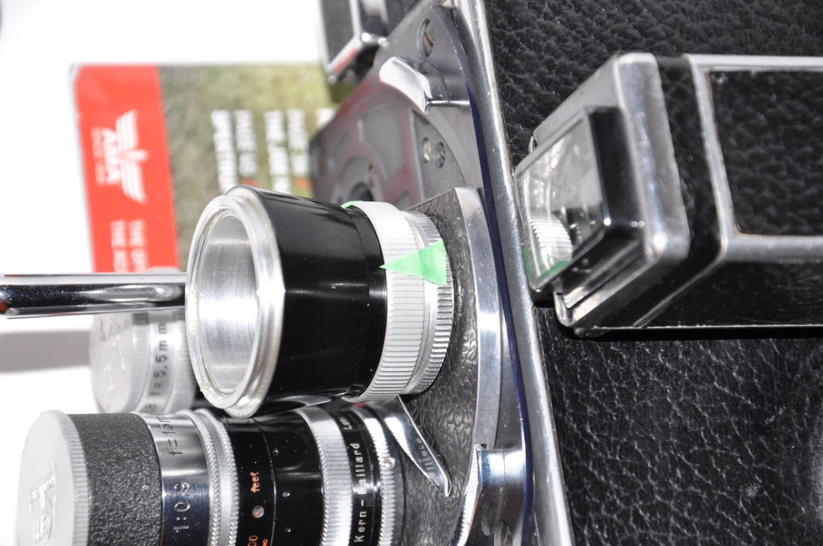

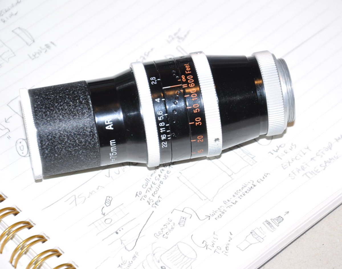

Don H Marks Posted May 8, 2024 Posted May 8, 2024 (edited) I found a 75mm Yvar and it works great on my H8 non-REX with the adapter I got off e-bay. For those that don't use 8mm, the lens is useable on that camera because the H8 Octameter has a 75mm setting. After servicing the helicoid, it was easy to re-assemble the lens so the index marks were in the correct positon with the adapter in place. For this camera I want the index marks of all the lenses on the left side. Edited May 8, 2024 by Don H Marks
