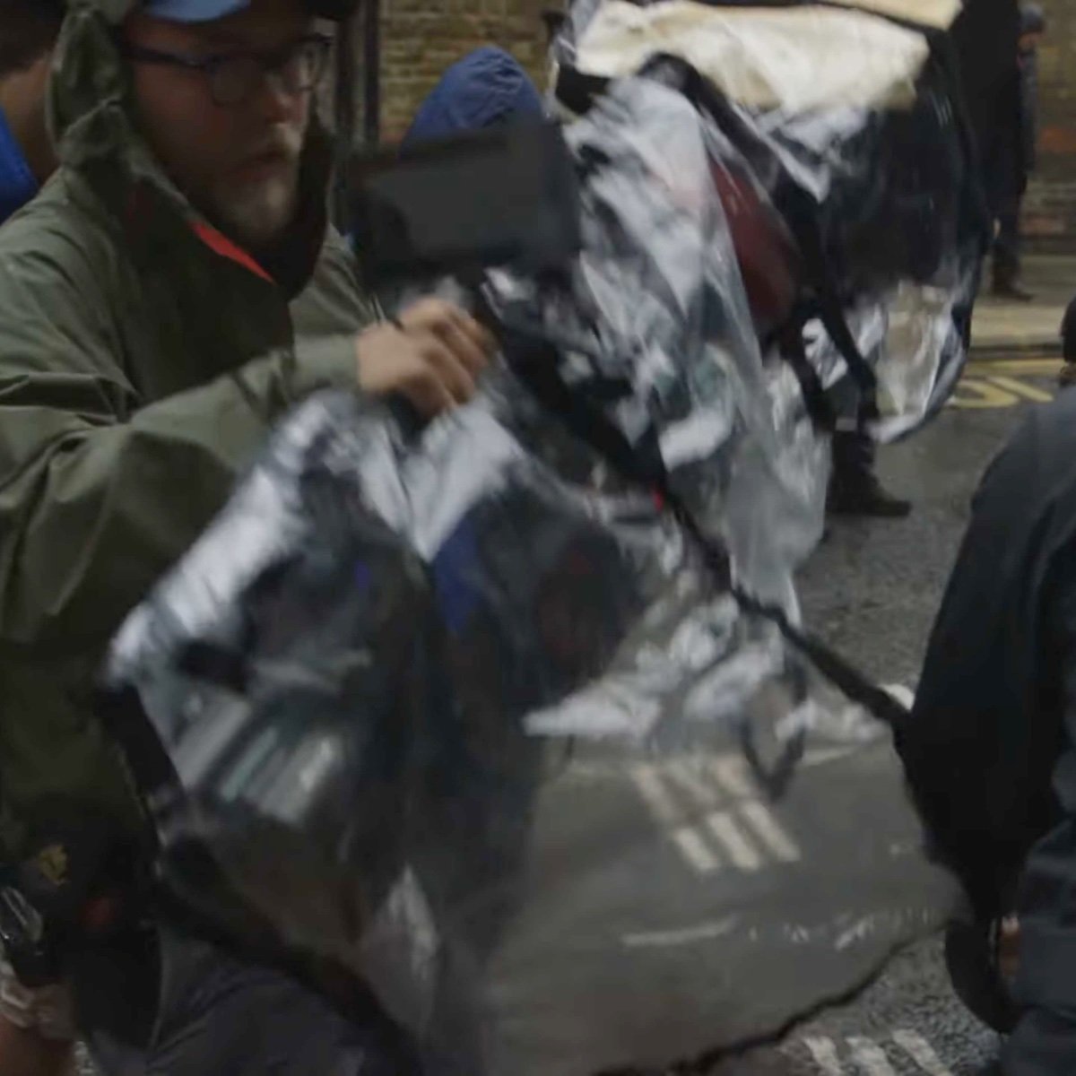

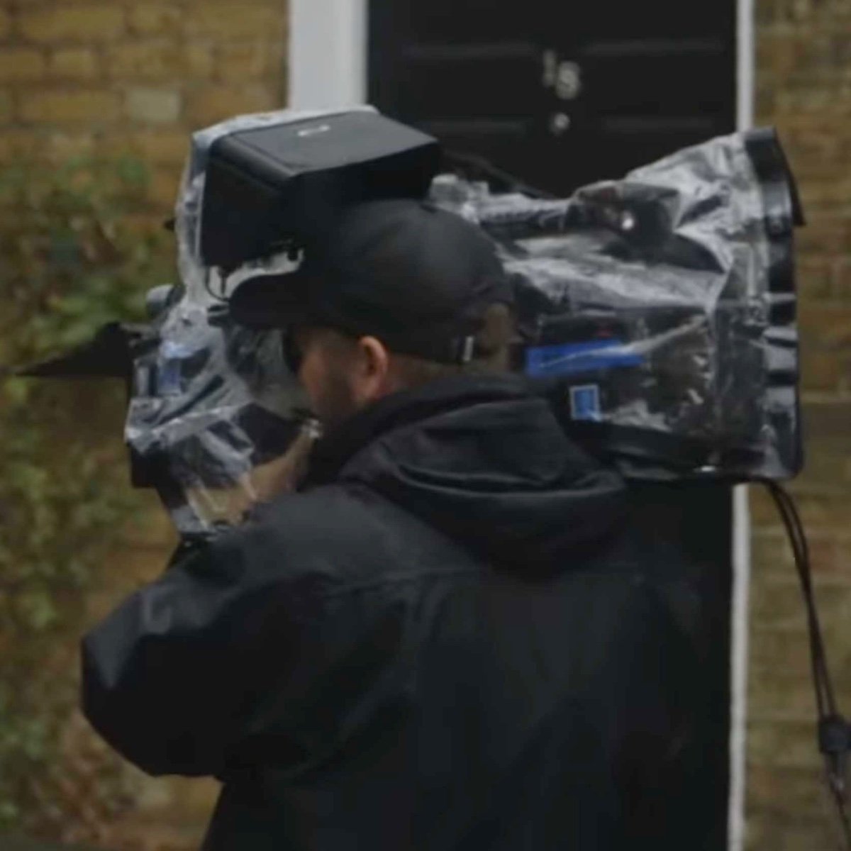

Premium Member Hannes Famira Posted October 26 Premium Member Posted October 26 In these BTS shots of The Crown they are using interesting rain slickers. Question, are these custom made from clear painter’s plastic and black gaffer tape (sticky velcro?) or does anybody recognize this as an existing product? I have a rain slicker that is always a little too short for a long lens and the little clear "windows" still hide too much of the camera. I love that you can just see what's going on underneath these rain slickers.
Joerg Polzfusz Posted October 27 Posted October 27 Maybe some cape from Eva marine? https://ewa-marine.com/
Joerg Polzfusz Posted October 27 Posted October 27 Sachtler‘s capes aren’t transparent enough: https://www.sachtler.com/en/product/transparent-raincover-for-full-size-broadcast-cameras/ Camrade‘s capes are also not transparent enough: https://www.camrade.com/products/raincovers But there might be other manufacturers that normally only produce rain capes for DSLRs, e.g. Ruggard, OP/TECH, Movo, … 1
