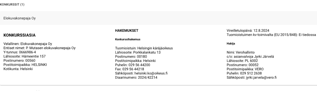

Premium Member Aapo Lettinen Posted August 31, 2024 Premium Member Posted August 31, 2024 (edited) 4 hours ago, Boris Kalaidjiev said: 1) You can get a V-mount Adapter from: https://elokuvakonepaja.com/product/aaton-power-adapter/ It has 3x 2-pin lemo outputs + 1 D-tap Elokuvakonepaja was closed permanently in June2024 and applied for bankrupcy in August. The site is still up but don't try to make any purchases, possible to lose the money even! Edited August 31, 2024 by Aapo Lettinen 1

Robin Phillips Posted August 31, 2024 Posted August 31, 2024 6 hours ago, Aapo Lettinen said: Elokuvakonepaja was closed permanently in June2024 and applied for bankrupcy in August. The site is still up but don't try to make any purchases, possible to lose the money even! so they're definitely closed? yikes. by any chance do you know who else is making regulated battery plates for film cameras now?
