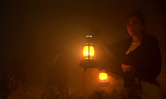

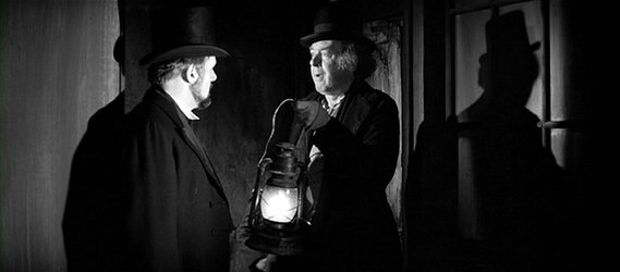

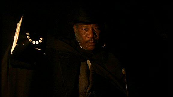

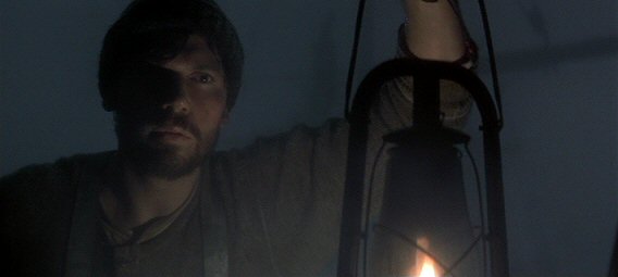

Premium Member David Mullen ASC Posted June 29, 2007 Premium Member Posted June 29, 2007 Here are some lantern shots I collected for research: They all use an electric bulb, either in place of the flame in a frosted lantern, or hidden behind the flame, or in the final example from "The Elephant Man", an off-camera light, which is the more classic way of faking a lantern effect.

Premium Member David Regan Posted June 30, 2007 Premium Member Posted June 30, 2007 They all use an electric bulb, either in place of the flame in a frosted lantern, or hidden behind the flame, or in the final example from "The Elephant Man", an off-camera light, which is the more classic way of faking a lantern effect. When using an off camera light like this, do they simulate the movement of the latern by moving the off camera lights correspondingly? It seems if you didn't the illusion would be lost, and having to do so would be a hassle.
Premium Member David Mullen ASC Posted June 30, 2007 Premium Member Posted June 30, 2007 Watch that sequence in "The Elephant Man" or a similar sequence with a candle in Deborah Kerr's hands as she moves through the house in "The Innocents" (also shot by Freddie Francis). You'll see a real choreography of moving lights on dimmers.

Premium Member David Mullen ASC Posted June 30, 2007 Premium Member Posted June 30, 2007 You can see in those frames from "Days of Heaven" and "Snow Falling on Cedars" that the faces are underexposed realistically.
