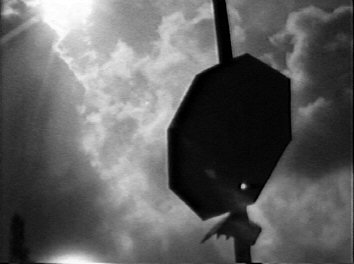

Premium Member David Mullen ASC Posted January 5, 2011 Premium Member Posted January 5, 2011 These are frame grabs from an old VHS transfer of a Super-8 short I did, so rather soft, but it was a Sankyo XL with a wide-angle adaptor: 1

alexandros petin Posted January 12, 2011 Posted January 12, 2011 The second frame grab is really nice!!

Benjamin Dietze Posted August 24, 2013 Posted August 24, 2013 Bob, specifically what adapter were you using on that beautiful b/w footage? Digging especially that low Dutch angle shot at the top here. And how exactly did you get Ringo Starr to star in your short? :D Sorry, of course I meant David here, not Bob. Doh! :wacko:
