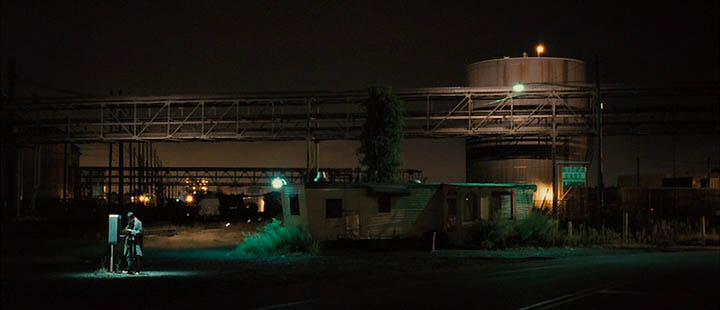

Premium Member David Mullen ASC Posted August 11, 2015 Premium Member Posted August 11, 2015 I did this shot at night where I put a mercury vapor lamp on the corner of the trailer and put an overhead spot with Cyan 60 gel on it over the phone booth but another white tungsten spot on the large tank behind the trailer: 1
