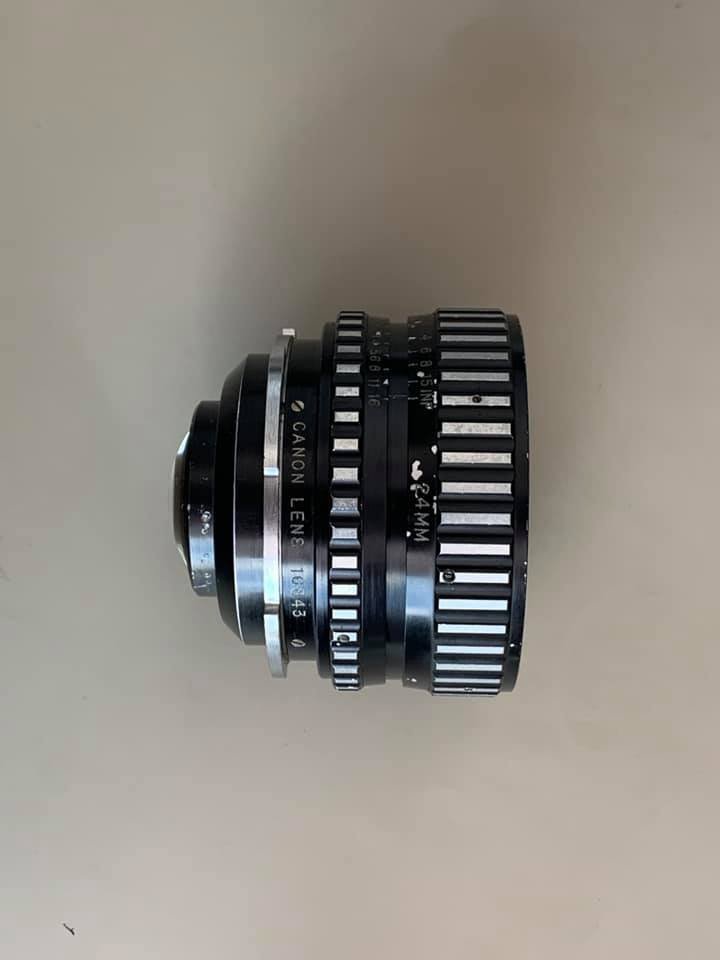

Premium Member Daniel J. Fox Posted September 11, 2021 Premium Member Posted September 11, 2021 On 4/18/2018 at 6:24 PM, Will Wertz said: Great! Thank you Ignacio. This looks to be a Cineovision rehousing for Sanwa rental house in China. These were apparently Cineovision versions of the K35s, so rehousing Canon FD glass. The housings are different to the standard Cineovision rehousings, which used a mixture of base lenses, mainly Zeiss Contax, OM, some FD, Carl Zeiss Jena, Leica and possibly some Zeiss Standard Speeds. I have several of these lenses, a mix of PL and BNCR. Attached is a 24mm Cineovision, also made for Sanwa.
