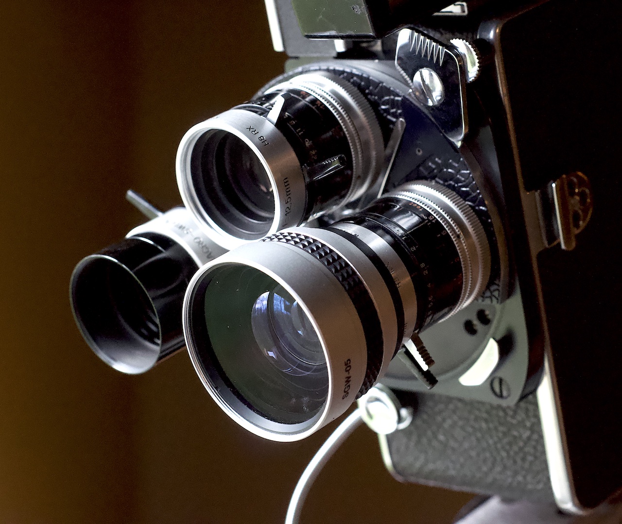

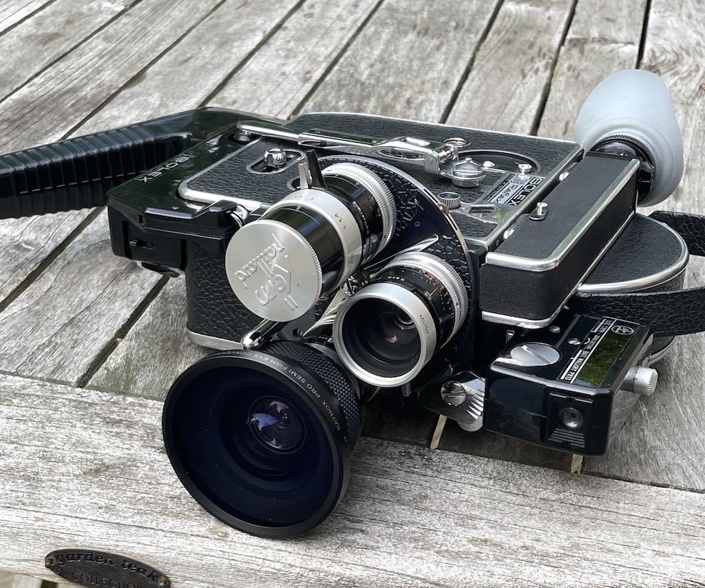

Don H Marks Posted December 5, 2024 Posted December 5, 2024 (edited) Nice way to adapt that lens. I was wanting somethng similar but went about it different. I had an adapter made that allows a 37mm thread adapter screw into the front lenshood thread of my 5.5mm Switar (Standard-8). I put this Raynox 0.3 fisheye adapter on the lens. Edited December 5, 2024 by Don H Marks

Don H Marks Posted December 5, 2024 Posted December 5, 2024 (edited) Other 37mm thread lenses can be put in front of the 5.5mm Switar. This is a Kenko 0.5 wide converter. This is my substitute for a Kern Aspheron that they never made for this lens ( don't know if the Kern Aspheron for the 10mm lens works on this 5.5mm lens). Seems no one wants these 'Camcorder' accesory lenses and they can be found pretty cheap these days. Edited December 5, 2024 by Don H Marks
