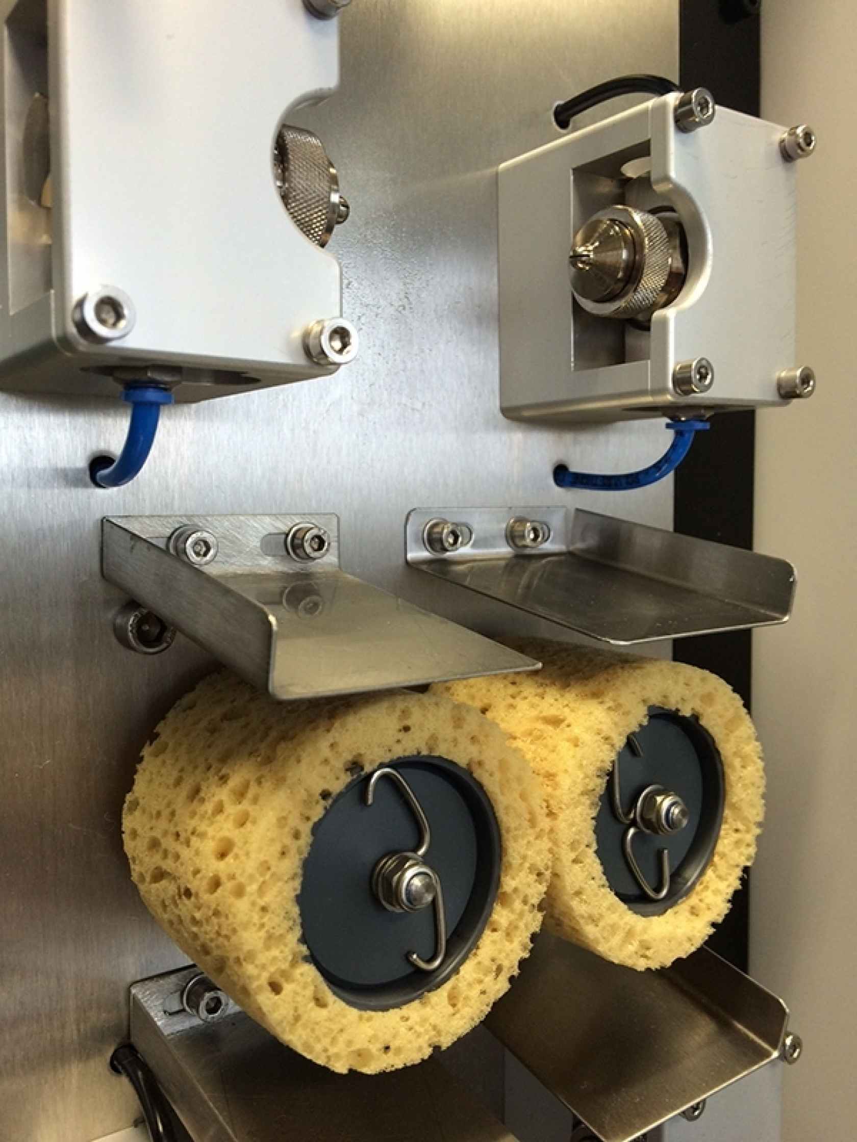

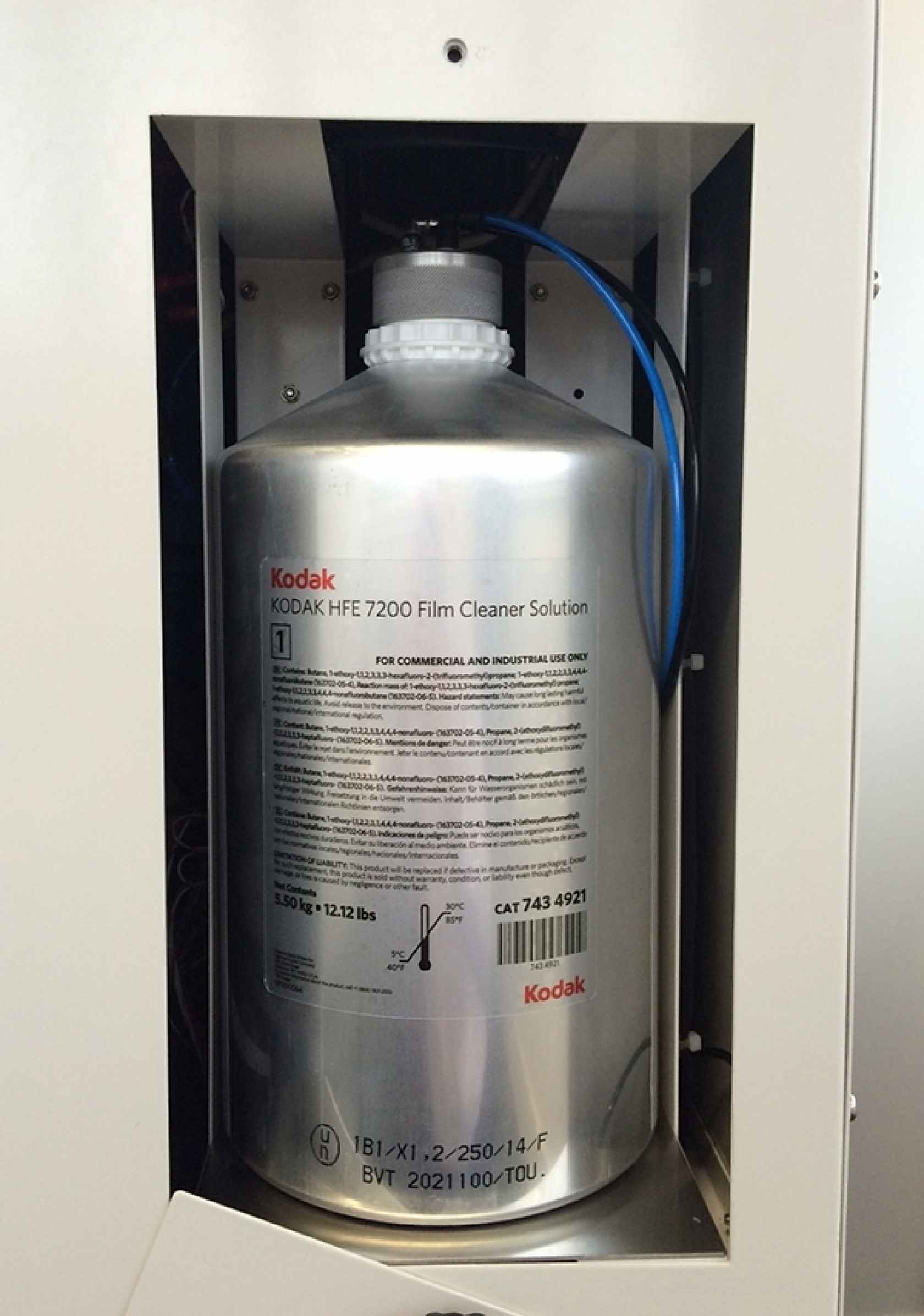

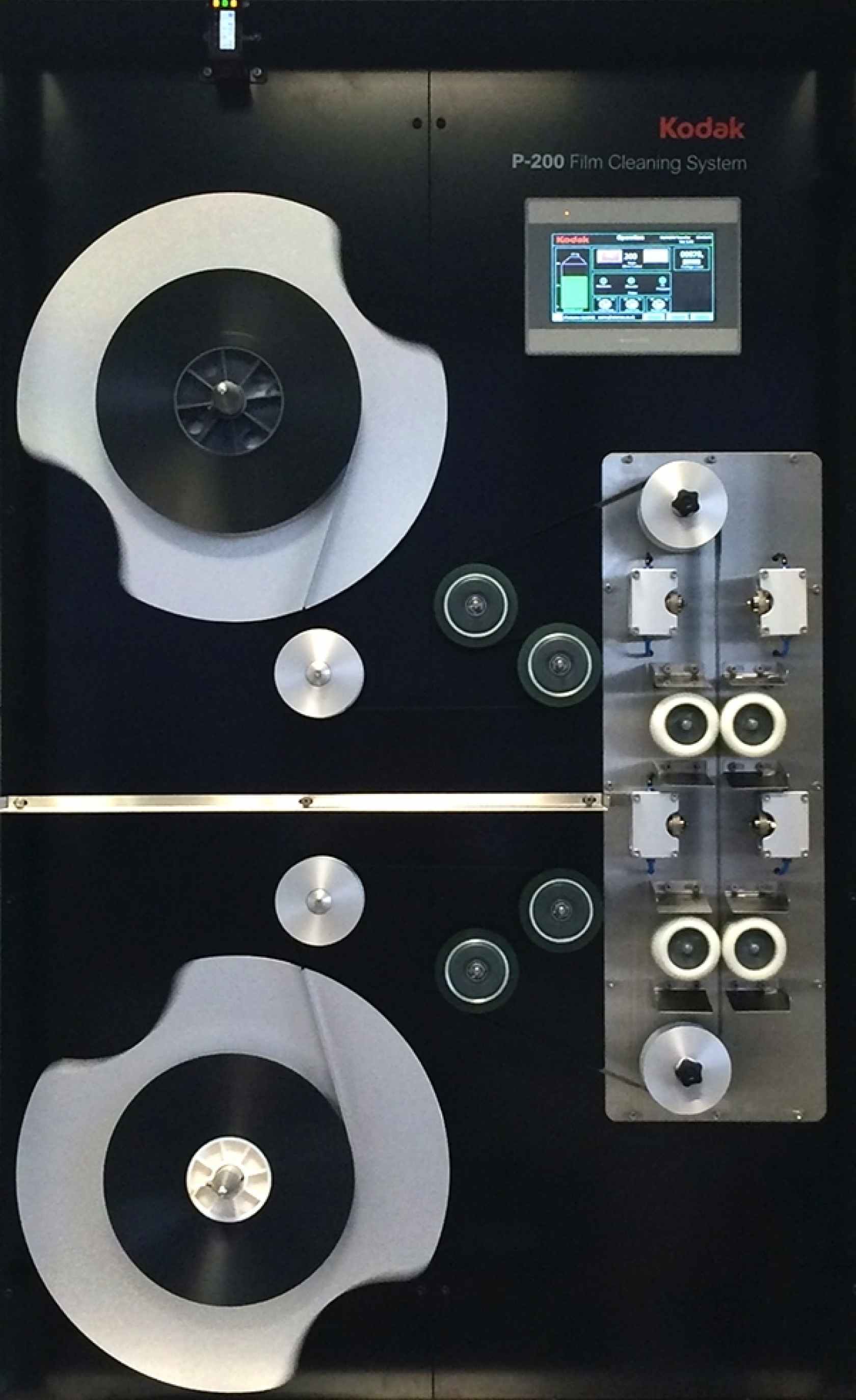

Daniel D. Teoli Jr. Posted March 11, 2024 Posted March 11, 2024 Is the Kodak P-200 machine still being produced? Do these P-200 rollers hold up? Looks like they would deteriorate. The cleaner? B&H has it for $800 a can...special order. The machine itself looks pretty nice.

Justin Lovell Posted April 6, 2024 Posted April 6, 2024 We have a p200 Kodak about to go up for sale. It is modified for 8 mm 16 mm and 35 mm. A very good machine.
