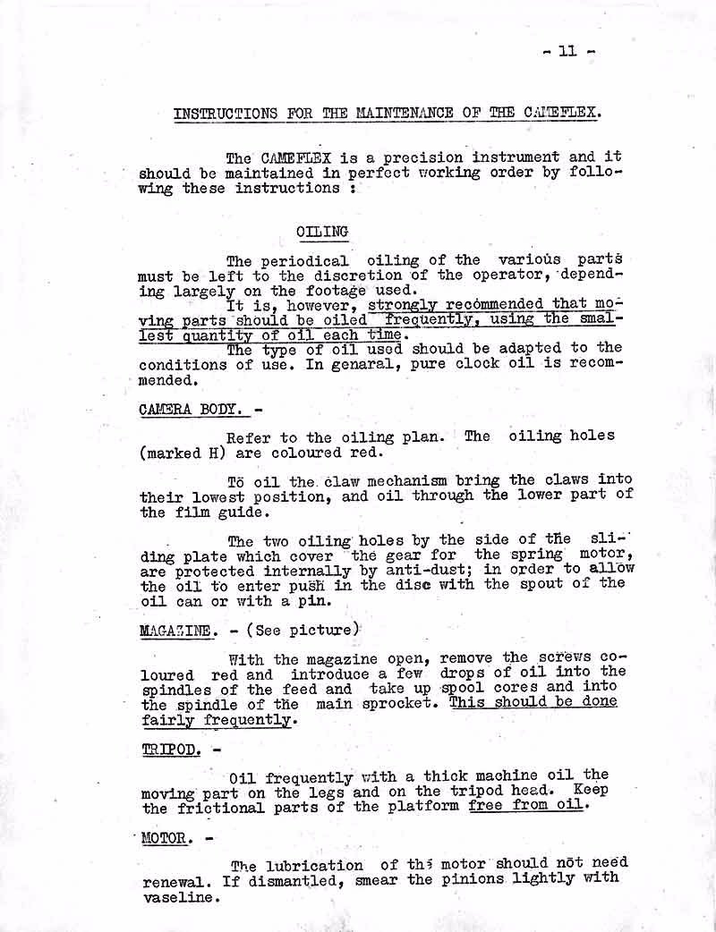

Boris Belay Posted April 17, 2023 Posted April 17, 2023 Joao, There is a lubrication chart in the back of the Cameglex manual. Have you look at it ? It's rahter important for these older cine camera, which require frequent lubrication. I would use any decent fine oil, as the chemical industry has made substantial progress in the many decades since the Cameflex was introduced. A few drops should do. Marek, nice strip down pdf. I have a fair bit of Cameflex parts, in case you ever need something to keep yours running. I focus mostly on ACLs... 1
Joao Paulo Miranda Maria Posted April 17, 2023 Author Posted April 17, 2023 5 hours ago, Boris Belay said: Joao, There is a lubrication chart in the back of the Cameglex manual. Have you look at it ? It's rahter important for these older cine camera, which require frequent lubrication. I would use any decent fine oil, as the chemical industry has made substantial progress in the many decades since the Cameflex was introduced. A few drops should do. Marek, nice strip down pdf. I have a fair bit of Cameflex parts, in case you ever need something to keep yours running. I focus mostly on ACLs... Thank you Boris, I don't have the manual. I just found some informations on internet. If you have this chart, please share it. All the Best!
Boris Belay Posted April 18, 2023 Posted April 18, 2023 I can't remember where I found it, but it was somewhere on the web. 1
Joao Paulo Miranda Maria Posted April 18, 2023 Author Posted April 18, 2023 1 hour ago, Boris Belay said: and finally: Thank you Boris, I tried hard to find the complete illustrated manual in pdf. I found one English version but is not the same as your.
Marek Budzynski Posted April 19, 2023 Posted April 19, 2023 This is a message for Boris. I don't think I have a copy of your Cameflex manual. Would it be possible to get a PDF? I'm always interested in Cameflex parts. Original screw particularly. I also have a bunch of parts if you ever need anything specific. I started reformatting the BBC Cameflex Technical document in order to add new photos etc. I'll give that a go over the next few months and send links to the finished document. I have one question. Your manual says use a special depth gauge after reassembly. How would you suggest adjusting the distance other than rotating the brass lens adapters. Is this even possible with Nikon adapter conversion? Sorry about all the questions. Cheers Marek 1
