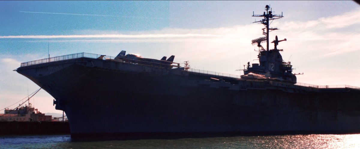

Premium Member Tyler Purcell Posted May 26, 2024 Premium Member Posted May 26, 2024 1 hour ago, Owen A. Davies said: the screenshot below belongs to Webster Colcord, but he provided me the RAW footage where I gave it a simple color grade out of a strong blue tungsten balance to what you see below. It's 2-perf, shot with the original Baltars, and on VISION2 200T 5217. That shot does not look like it was captured in the 1950's at all. Appears like a "look" applied to modern stock. No shot in anything from the 1950's would ever look like that. The shot would be a model and it would be lit with arc's. They wouldn't waste their time shooting a real ship and have that harsh shadow. Too expensive to light properly. I think you're more obsessed with the slight color tint, rather than what actually makes the "look" of the movies you described. 1

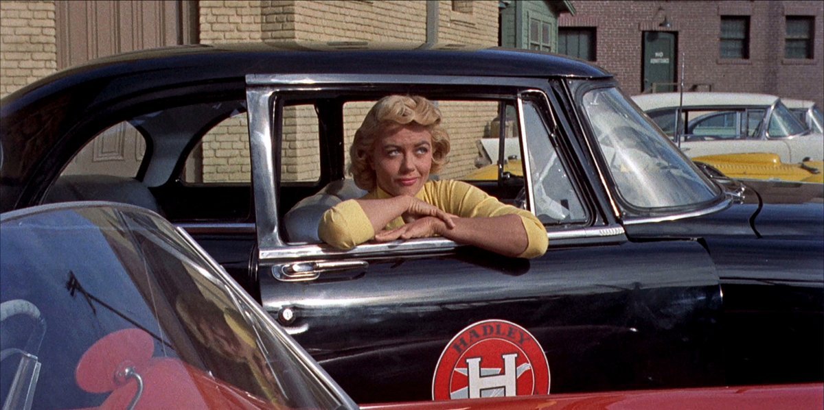

Premium Member David Mullen ASC Posted May 27, 2024 Premium Member Posted May 27, 2024 You could look at something like this blu-ray transfer of "Written on the Wind" (1956) for example. Probably not a scan of the original negative. Despite being shot on 25 ASA stock (5248), it's not super fine-grained for example, and not super sharp either -- despite being shot under full sunlight. 2 1

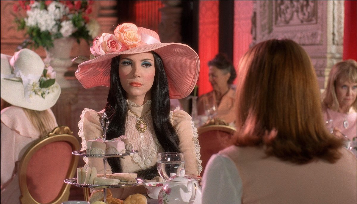

Premium Member David Mullen ASC Posted May 27, 2024 Premium Member Posted May 27, 2024 Here is a shot from dailies for "The Love Witch" -- in this case 250D instead of 200T because I couldn't gel the daylight windows. Zeiss Super Speeds (so a bit sharper than the Cookes and Baltars of the 50's and 60's) but with some diffusion on the lens (a light net combined with a 1/8 Classic Soft filter.) 3 1
