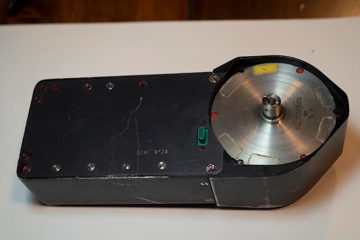

Premium Member Tom Hepburn Posted June 24, 2024 Author Premium Member Posted June 24, 2024 I wanted to get back to this. As you can imagine I still haven't found an inching knob, but I'm not giving up yet 🙂 I had a thought that I wanted to run by here. The inching knob doesn't seem like a very complicated component, correct me if I'm wrong. I mean it doesn't seem to require all of the accurate adjustments and calibrations that some other components might. If that's the case, it seems like a handy person or machine shop would be able to fabricate one. I would just need the proper reference with measurements etc. Any thoughts? Hopefully this will display in the regular size font....my phone made it large. Thanks, Tom

Premium Member Duncan Brown Posted June 24, 2024 Premium Member Posted June 24, 2024 That motor looks a little different from the ones I've seen, so I'm not entirely sure how it would have been originally, but I will say the ACL motors Ive dealt with have deceptively complicated inching knobs. They're one-way-clutched. I'm not sure if that's so you can't inch them backwards (who cares) or so they don't grab a string from the camera operator's sweater and end up choking them to death... Duncan
Premium Member Steven Jackson Posted June 24, 2024 Premium Member Posted June 24, 2024 3 hours ago, Tom Hepburn said: I wanted to get back to this. As you can imagine I still haven't found an inching knob, but I'm not giving up yet 🙂 I had a thought that I wanted to run by here. The inching knob doesn't seem like a very complicated component, correct me if I'm wrong. I mean it doesn't seem to require all of the accurate adjustments and calibrations that some other components might. If that's the case, it seems like a handy person or machine shop would be able to fabricate one. I would just need the proper reference with measurements etc. Any thoughts? Hopefully this will display in the regular size font....my phone made it large. Thanks, Tom If you take the cover off, held on by two screws, you would be able to see if there's any of the shaft left or whether it has been broken off. If all you need to do is make up a new inching knob and fix it to the shaft, you're probably in good shape, but if the shaft is broken I think you're out of luck.
Premium Member Tom Hepburn Posted June 25, 2024 Author Premium Member Posted June 25, 2024 A couple of updates I wanted to share. I found the manual that explains more about the motor. I can see that there was an inching knob in the reference pictures of the manual. Manual motor 1 Manual motor 2 I also removed the small plate to uncover what is there now. It does not seem to turn and I'm not sure in its "updated" state it's designed to. Obviously it has worked without the knob (see footage). motor plate removed Here is where I am: I want to test the motor, but I won't turn it on, or even connect a battery until I'm sure things move freely. It seems good that the mirror will park in position as per the manual, but I still need the knob to manually turn it to see if things are free. Any alternative to doing so other than the inching knob? Hope that makes sense. If I can confirm that things move smoothly and easily, I will get a battery and test the motor. As always I'm open to any thoughts on the subject. Thanks again, Tom
Premium Member Duncan Brown Posted June 26, 2024 Premium Member Posted June 26, 2024 OK so it looks like the clutch assembly would have been in that circular well in the body surrounding the motor shaft, whereas I think on some other motors it was farther away on the shaft. It looks to me like that's a screw thread there, going into the motor shaft. If you could remove that nub of screw, you could theoretically put on a new clutch/knob assembly, though goodness knows where you'd find one. Though it worries me that if it's broken off like that, it's because the motor is stuck. But here's how to find out, since you don't seem shy to disassemble things a bit: remove the motor from the camera body. Three long screws and pull it off... VERY CAREFULLY!!! Very straight. Bit by bit. Don't lever it off of center at all. There's a very very fragile mini connector in there whose housing will break if you get it off axis. I'll attach a picture of what it will look like. There's a motor shaft with two pins, that goes into a rubber coupling, which goes onto a shaft in the motor body with a similar two pin arrangement/ The rubber coupling will likely stay with the motor or the body as you pull it apart - don't lose it! SO at that point you should be able to turn the motor by hand, if it's free. You should also be able to reach into the camera body hole, easier if the rubber coupling is on the shaft in the body, and sort of turn it with your pinky, to see if the camera mechanism turns freely. Duncan

Premium Member Tom Hepburn Posted June 26, 2024 Author Premium Member Posted June 26, 2024 Update: turning smooth! The rubber coupler tried to make a run for it. Thanks for pointing that out Duncan. A little lubricant in there as well, which seems in good shape and not too thick or sticky. Next step is the battery. I'm assuming that a lot has changed since bescor battery belt. Any (4pin) recommendations? I just need to test it at full speed.
Premium Member Duncan Brown Posted June 26, 2024 Premium Member Posted June 26, 2024 Lubricant in with the coupler seems unnecessary, but as long as it's something like silicone which won't eat rubber it shouldn't really hurt anything. Duncan
Premium Member Tom Hepburn Posted June 27, 2024 Author Premium Member Posted June 27, 2024 Hello again, I have a quick update. I appreciate this site and the feedback thus far. It's much more of a friendly community compared to some other places these days. I manually turned to motor (thanks Duncan) to make sure nothing was locked or stuck. That was successful. A little lubricant was on the motor face which was not sticky or gummy. Today I ran it at 24fps and it purred nicely. See video links below. I spoke with Paul at Visual Products. He asked a few questions about it. Then said if it's been in an air conditioned controlled environment (which it has), he didn't think there would be any big issues if it worked fine before (understand that's not a film test). Confirmed that all of the magazines (1 400', 2 200') are French. Apparently this camera has automatic mirror parking? My understanding is that the inching knob is primarily used for this. If that's the case (and correct me if I'm wrong) the missing or removed knob seems a little less critical. In the below video you can see there is an automatic adjustment/sound after stopping the motor, which I assume is the mirror being parked. This video will probably explain everything better than I can. Shutter movie Again, I'm not the expert here so open to other feedback. Thanks, Tom
Premium Member Duncan Brown Posted June 28, 2024 Premium Member Posted June 28, 2024 I agree that's behaving like a mirror-parking motor though it's interesting that it more or less ends up at the right spot on its own and the "parking wiggle" is minor to nonexistent. The proof is kind of in the fact that once it's stopped you always have a perfect view through the viewfinder! (That being the point of mirror parking after all.) And you are correct that the inching knob is not nearly as critical a piece on a camera with a mirror that parks in the right spot. On a spool-loading camera like an Arri 16S, you really need the inching knob to help with loading the film, but on a magazine-loading camera like this...not so much under normal circumstances. We never asked, because we were just going by the pictures, but since you have it there in your hands: is there a little icon on the motor cover (the one you took off to see about the inching knob) that looks like a windshield? (I guess it's supposed to look like the shape of the mirror.) That's the other proof, if that's there and just wasn't obvious to us in the farther away pictures. Your viewfinder video brings up another question: what are the ground glass marking like? From that video we can see the original regular-16mm markings, but is there some other marking or shading in the S16 aspect ratio? Glad to hear this camera may live again! Duncan
