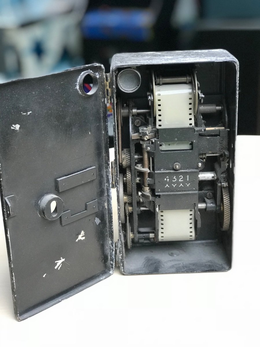

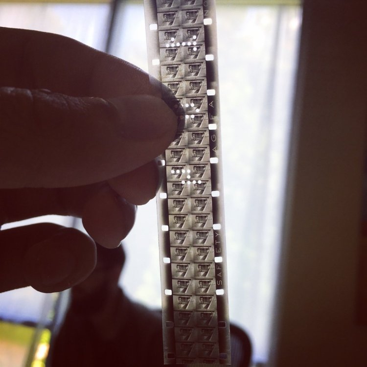

Greg Milneck Posted August 21 Share Posted August 21 On 8/7/2024 at 9:26 PM, Todd Ruel said: For some context, the projection scheme is S-shaped. (I like how Lasergraphics described it as serpentine. That's more accurate.) Here's a link to a web page that describes the brief, brief history of the company and the Kodel HoMovie format: https://www.kinocameras.com/apparatus/kemco-homovie Hi Todd, Thanks for linking to my site (kinocameras.com). I have a complete set in my collection with the projector and accessories. I have viewed several of the films. It's an interesting format for sure. I also have an early (unrelated) prototype movement that utilizes a very similar pattern, although on 35mm film. My camera came from the son of the inventor and includes a box of his early test films...I plan on transferring mine as well. I spoke with Jeff Kreines at Kinetta (http://www.kinetta.com/overview.html) and he thinks he can transfer them...give him a call. Let me know how it comes out. 1 1 Link to comment Share on other sites More sharing options...
Greg Milneck Posted August 21 Share Posted August 21 16mm HoMovie film 1 Link to comment Share on other sites More sharing options...

Greg Milneck Posted August 29 Share Posted August 29 On 8/7/2024 at 10:32 PM, Dom Jaeger said: What sort of films are they? Are they worth all the hassle of trying to digitize them? I wonder if Kemko ever made a viewer/editor for their system. Finding a working projector might be another route, though dangerous if the films are valuable or rare. I've always wanted to get my hands on a Kemko camera, to check out the mechanism. It was a pretty crazy idea, but they actually got it working. Standard 8 makes a lot more sense though. Yes, there is a companion projector. Ive viewed a few films on it...but because mine are the original test films I didnt want to risk it further. Standard 8 was what killed the Kemco...it was never a commercial success as Kodak quickly responded with 8mm film Link to comment Share on other sites More sharing options...

Greg Milneck Posted August 29 Share Posted August 29 36 minutes ago, Dom Jaeger said: I knew there was a projector, but I was wondering if they ever made a viewer/ editor for home movie editing. They tend to be a lot gentler on the original film than a projector, but still allow you to view the film. Not as simple to make for Kemco as the ones for 8mm though.. unfortunately the Kemco HoMovie was not a success, mostly due to Kodak's introduction of 8mm film shortly after Kemco brought their camera to market. Only about 200 HoMovie systems were ever produced. If you look here you can see the extent of the system: https://www.kinocameras.com/apparatus/kemco-homovie Link to comment Share on other sites More sharing options...
