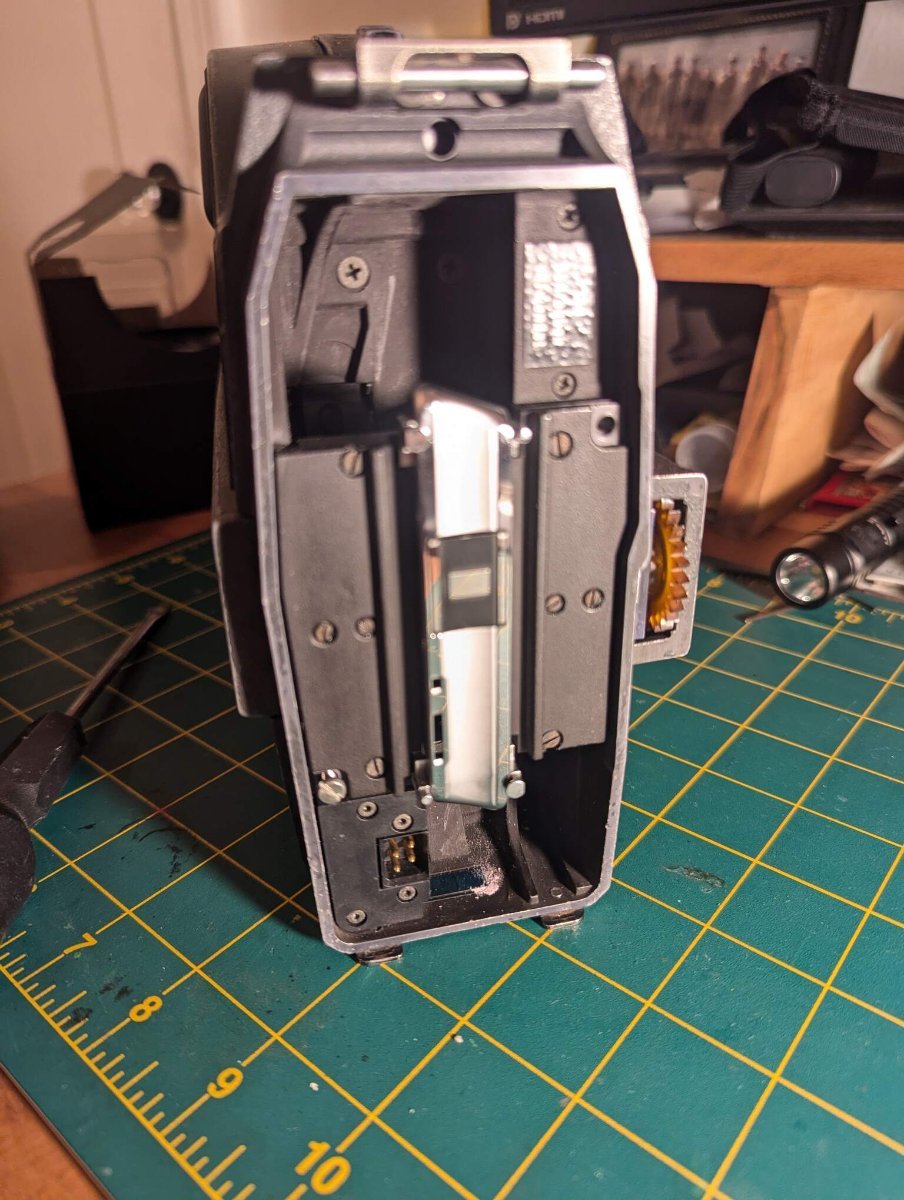

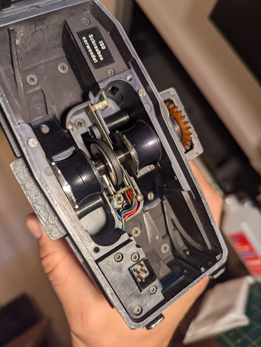

Josh Kuzo Posted September 23, 2024 Author Posted September 23, 2024 Hm, I think I've found my missing emulsion as this collection of dust at the bottom? Otherwise I wonder if it's actually not a scratch but an unwanted optical reflection somewhere inside? @Dom Jaeger I couldn't find anything obvious behind the pressure plate assembly. I included the pic but obviously there's many more angles to be covered for full diagnosis.
Premium Member Tyler Purcell Posted September 23, 2024 Premium Member Posted September 23, 2024 (edited) So this is a "tap" scratch in my opinion, the film is tapping something mid frame. Usually this is caused by the loop tapping something, either upper or lower. It's for sure emulsion side. That "dust" is absolutely emulsion. So start looking at your loop size. Are you properly using the film holders on the pressure plate? Check the screws that hold the guides inside the magazine (picture above) and make sure there is nothing that could touch the film. Edited September 23, 2024 by Tyler Purcell
Jon O'Brien Posted September 23, 2024 Posted September 23, 2024 (edited) 2 hours ago, Josh Kuzo said: Hm, I think I've found my missing emulsion as this collection of dust at the bottom? Otherwise I wonder if it's actually not a scratch but an unwanted optical reflection somewhere inside? @Dom Jaeger I couldn't find anything obvious behind the pressure plate assembly. I included the pic but obviously there's many more angles to be covered for full diagnosis. Ah, so it's not actually a scratch on the film? If it's a scratch, you will see the physical scratch on the surface of the film if you hold it up to the light at the right angle. Check it with a loupe/hand lens in a good light. But you think it might be an optical effect? That's a whole different kettle of fish. It holds steady and it's not just a general 'burn' of the film frame. Therefore something inside the camera that's shiny and is reflecting light. Have a good look with a torch. Might be a bit of shiny surface in the camera that shouldn't be there, just inside the lens mount. Edited September 23, 2024 by Jon O'Brien
Premium Member Tyler Purcell Posted September 23, 2024 Premium Member Posted September 23, 2024 14 hours ago, Jon O'Brien said: Ah, so it's not actually a scratch on the film? It's 100% a tap scratch. Reflections can't do that. The key is how it moves and how it flickers. Those are two indications. You may not see it on the emulsion if you aren't trained properly. You have to look at the bounced reflection from a soft white light source in order to actually see the scratch. We have one built into our scanner box and on our inspection table, it's critical for determining where scratches are. This is a common issue when the loop size is too big.
