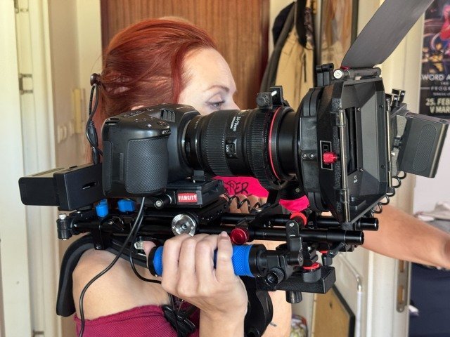

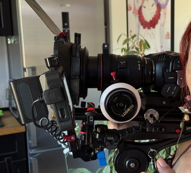

Vital Butinar Posted Monday at 04:44 AM Author Posted Monday at 04:44 AM Hey guys. I just wanted to get back to you all and thank you for your ideas on the camera rig. In the end we were able to rig the camera on her original shoulder rig but push the camera way back and extend the monitor forward. Which is great because I got to have a video feed because of the monitor. She's super happy with it and shoots really long days with it, but she additionally created a kind of shoulder pad, that she puts on as a sleeve, giving her some added padding and apparently it works great. We've been in production for 3 days now, each of them not shorted than 10 hours and no longer than 14 hours. Because of this rig we've shot over a third of the scenes of the feature. We still have 6 to 7 production days to go, but none of them, except one, will be longer than 10 hours. We've only used sticks for 5 shots and two dolly shots. So the rig is helping us soot very productively. One interesting note, I know this is a cinematography forum, but shooting with 32 bit lav mics that run the entire day and record the audio internally is also a benefit because we can just leave the audio running and monitor it during takes. If there's any sound problems it can be fixed in post with voice isolation. I've already tried it and tested it and it works great! Anyway thanks for all the help!
