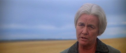

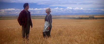

Premium Member David Mullen ASC Posted January 6, 2006 Premium Member Posted January 6, 2006 Well, it's a mistake to think that you always have to "use" the whole width of 2.35. One of its greatest strengths is the ability to use large amounts of "negative space" to create a feeling of distance, isolation, loneliness, imbalance, etc. You look at the use of the 2.35 frame here in "Superman": Not only does the widescreen frame emphasize the flatness and expanse of the landscape, but it also is used to suggest Ma Kent's approaching separation from her son by the way that her close-up is framed, without part of him in the frame. Of course, no aspect ratio is better than another -- they all can be used artistically, The squarer ones are perhaps better at "balanced" framing, symmetry (ala Kubrick) but the widescreen ones, being more "awkward" perhaps strike me as more "modern", like modern art, creating alienating spaces and making imbalance in framing more powerful. The other advantage to 2.35 can only be felt in a large theater -- the edges of the frame engage your peripheral vision more, making the image feel more immersive, the old Cinerama effect. IMAX does something similar by just being larger in all directions, but in a conventional theater space, it is easier to build a screen larger in the horizontal direction, hence why Fred Waller when developing Cinerama mainly concentrated on maximizing peripheral vision on the sides. Here is a painting by Andrew Wyeth that was one of the inspirations for me when shooting "Northfork": It's like a CinemaScope frame, unusual for paintings.
