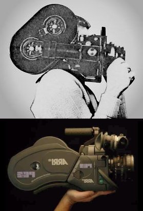

Leo Anthony Vale Posted September 29, 2007 Posted September 29, 2007 BTW, the AC article about 2001 says that a special Fairchild wide angle lens was used for HAL's POV shots. I would have thought it was a Nikkor fisheye because of the area the image occupies. It must have been Fairchild that made Trumbull's bugeye knockoff. Here's a May 1960 AC article from the widescreenmuseum titled 'Panavision's Progress': http://widescreenmuseum.com/widescreen/panavisn.htm It deescribes and shows the 65mm studio and hand held cameras. Does that look so hard to handhold?
Thomas James Posted September 29, 2007 Posted September 29, 2007 It seems that the powers to be namely the producers have assumed over the years that audiances simply do not care about 70mm film productions so why spend the extra money to produce these movies. However with all the emphasis lately on high definition home theatre it seems that audiances are now more than ever aware of the advantages of higher resolution formats and would really appreciate the greater picture quality that 70mm affords. As far as the objection that 65mm cameras are impossible for hand held shots it seems that good ergonomics have already been achieved with the classical diagonal reel designs.
Premium Member Michael Lehnert Posted September 30, 2007 Premium Member Posted September 30, 2007 As far as the objection that 65mm cameras are impossible for hand held shots it seems that good ergonomics have already been achieved with the classical diagonal reel designs. That is very interesting and would come as a surprise to many who think of 65/70mm mainly in form of the Arriflex 765. Below's photo attachment is of course not an exact 1:1, but I think quite close comparison. It's an attempt to show how much more could be done were there real will to push the format (and how much more has apparenty been forgotten or left unimplemented for a long time in size-oriented camera building by an industry who prides itself of its continuous history) It seems that the powers to be namely the producers have assumed over the years that audiances simply do not care about 70mm film productions so why spend the extra money to produce these movies. However with all the emphasis lately on high definition home theatre it seems that audiances are now more than ever aware of the advantages of higher resolution formats and would really appreciate the greater picture quality that 70mm affords. I fully agree. David Mullen made a similar point earlier. Maybe with a greater degree of exposure and awareness in the industry, our voiced opinions could transform into a positive trend for that format. Yeah, maybe it is the fringe formats, Super 8 for HD on one end, and 65/70mm for grand theatre projection on the other, that have the most potential to develop increasingly stalled film rhetorics and entice audiences anew. It would all boil down to good marketing and clever costing/pricing; and a convincing voice to confront "the suits" on their own terms.
Premium Member Satsuki Murashige Posted September 30, 2007 Author Premium Member Posted September 30, 2007 Does that look so hard to handhold? Nope, that looks shockingly compact and ergonomic! Of course, that cameraman's hands look like bear paws so I suspect that camera would look much bigger on my shoulder. I'll bet it sounds like a lawnmower next to your ear at 24fps. ;)
