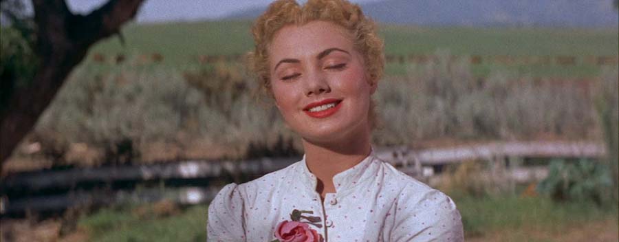

Premium Member David Mullen ASC Posted November 5, 2014 Premium Member Posted November 5, 2014 I was looking at the new blu-ray release for "Oklahoma!", comparing the 30 fps 65mm spherical version (Todd-AO) to the 24 fps 35mm anamorphic version (CinemaScope). The 30 fps version is slightly smoother but it's not a radical difference between that and the 24 fps version. The 65mm version is definitely less grainy and is sharper. It's interesting to note the subtle differences in depth of field because in some respects, 65mm spherical and 35mm anamorphic use similar focal lengths to achieve the same field of view (i.e. roughly double compared to standard 35mm) but obviously the CinemaScope bokeh is different, though not as stretchy compared to Panavision anamorphics, which got rid of the CinemaScope "mumps" (fatter faces when the camera focused closer to minimum) by letting the background get more compressed in order to keep the subject at a consistent 2X squeeze. 65mm 35mm 65mm 35mm 65mm 35mm

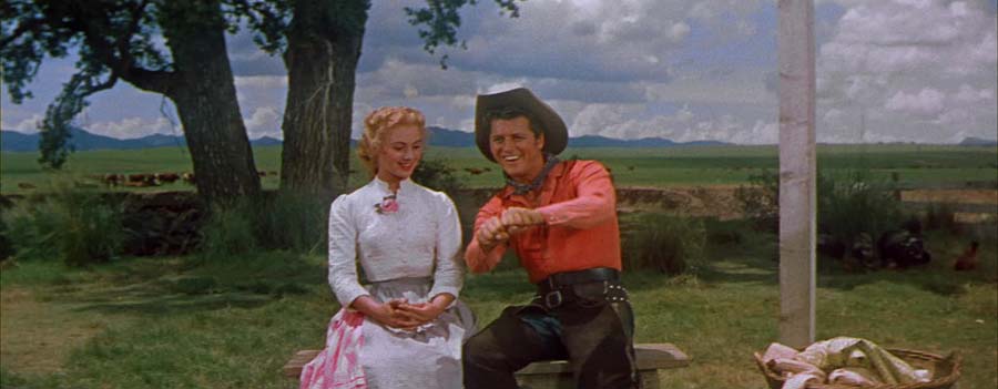

Premium Member David Mullen ASC Posted November 5, 2014 Author Premium Member Posted November 5, 2014 Since I didn't post the full 1080P frames, here is an enlargement of a portion of the frame to see the grain and sharpness difference: 65mm 35mm
John Holland Posted November 5, 2014 Posted November 5, 2014 That is quite a increase in grain there.
Premium Member David Mullen ASC Posted November 5, 2014 Author Premium Member Posted November 5, 2014 I don't know the state of the original elements, but since it is likely that the 35mm negative was printed from a lot more often, there's a chance that current masters are being made from 35mm b&w separations, whereas the original 65mm negative may be usable for scanning. On the other hand, you'd expect the 35mm version to be nearly twice as grainy.
Kenny N Suleimanagich Posted November 5, 2014 Posted November 5, 2014 The colors on the 35mm version are a little more blotchy by comparison - is that also to do with grain structure? I also wonder: did they shoot with two cameras side-by-side?
Premium Member David Mullen ASC Posted November 5, 2014 Author Premium Member Posted November 5, 2014 It looks like they shot side by side for many of the big wide shots, but otherwise, the 65mm version was generally shot last, figuring things would have been worked out during the 35mm takes.

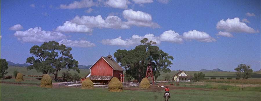

Premium Member David Mullen ASC Posted November 5, 2014 Author Premium Member Posted November 5, 2014 In the shots I posted, the clouds show that the two versions were shot at the same time, but for this shot, which is a slow dolly in from full to medium, the 65mm version was shot after the 35mm version: 65mm 35mm You can see how the corner sharpness of the CinemaScope lenses aren't great by looking at the tree on the left.
David Cunningham Posted November 5, 2014 Posted November 5, 2014 I find it most interesting that the colors are completely different in the two examples. You would think those doing the color grading would have talked to each other and created a more uniform look. The 65mm looks more natural and correct to me. The 35mm looks over saturated and contrasty... weird.
Kenny N Suleimanagich Posted November 5, 2014 Posted November 5, 2014 Thanks for those references. I was indeed looking at the clouds, which looked the same. The 35mm still of the landscape with carriage looks very painterly, but I don't like what it does to her skin tones. It could have also been the way those anamorphics were coated? The image does look more contrasty to me, which might explain the slight bump in saturation?

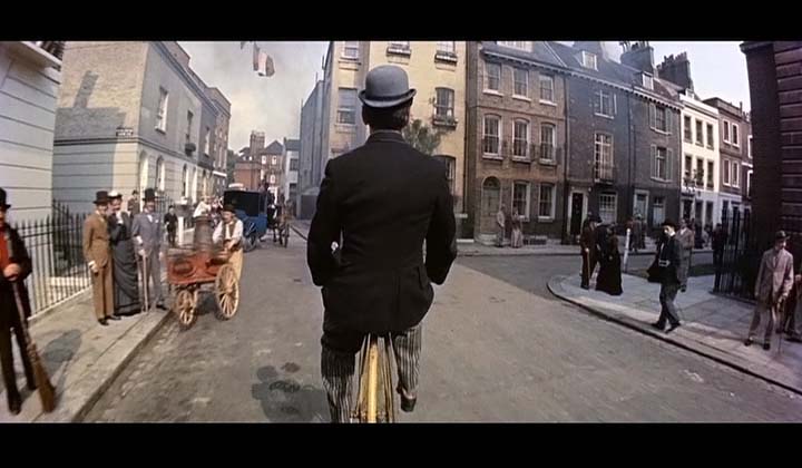

Premium Member David Mullen ASC Posted November 6, 2014 Author Premium Member Posted November 6, 2014 Have you seen the Cinerama travelogues that are now out on blu-ray? Just to show the difference in barrel distortion between the bug-eye 65mm Todd-AO lens versus the three 27mm Ektar lenses on the Cinerama camera: Around the World in Eight Days (Todd-AO) Cinerama Holiday (Cinerama)
Premium Member Dom Jaeger Posted November 6, 2014 Premium Member Posted November 6, 2014 No I haven't seen the travelogues. Nice shot comparisons. Lots of barrel distortion in that bug-eye, but what a vista for a single lens at that time! And no noticeable dimming in the corners. Was that lens considered a real breakthrough? As I'm sure you're aware David, the online Widescreen Museum has very detailed sections on both CinemaScope and Todd-AO, which I just re- read. There are quite a few production stills from 'Oklahoma!' that show both camera systems set up next to each other: http://www.widescreenmuseum.com/widescreen/wingto6.htm Although the combination CinemaScope lenses that I showed an example of above were developed in 1954, it seems the earlier CinemaScope adapter placed in front of a Baltar lens was used on 'Oklahoma!'. Which meant both optics had to be focussed separately.
